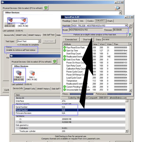

    Hello
    I'm looking for an application to watch the two hard disks in my Windows 7 workstation, and just gave DiskCheckUp a try.
    However, for both of them, DCU shows a red stop sign and says that it's "Unable to retrieve self test status". Likewise, it's unable to retrieve the disks' Model and Firmware infos, while SpeedFan has no problem:
    Does someone know why DCU can't work with those drives and if there's a work-around?
    Thank you.

        • 11135
        The post is a bit old now, but if the original poster wants to get to the bottom of the issues, then please run DiskCheckup in debug mode. (using -d on the command line) and then E-mail us the log file.
        Also supply details of the hardware involved & how the drives are connected to the motherboard (USD, SATA, IDE, etc..).
        Also make sure no 3rd party software is running.

            Same here, following the advice of others posters hasn't been of any help.
            @palaadin: How does antivirus solved it for you ? I completely disabled mine and no beuono still :S
            David (PassMark): Where do i find your email ?
