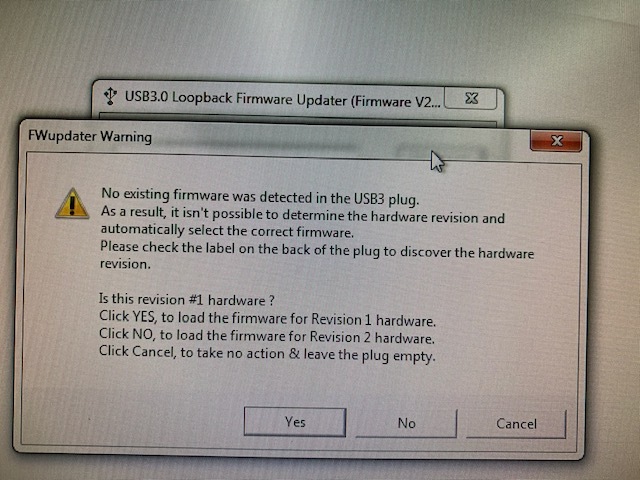

    After unzip the file, I run the file .exe and plug in the USB loopback 3.0 then press "Program" button. But the error message shows up as below

    I tried to click "Yes" for one USB loopback and click "No" for the other USB loopback. Then both USB loopback seems dead. No LED on after that.

    At the risk of asking the obvious question (the same question as the one in the window).
    What hardware revision are you running?
    • HamidK (PassMark)
      • Jul 2016
      • 47
      If you had FW1.4 & 1.7 on your plugs, then most likely plugs are revision 1 and you should have clicked Yes.
      Did the updater tool show any error during the firmware update?
      Does Windows OS recognize the plug when it is inserted into the machine (Either in Windows Device Manager or USB connection chime when you insert/remove the device)? If it does, possibly the update process was interrupted, so you just need to run the FWUpdater again to load the firmware. The updater tool can be downloaded from here,
