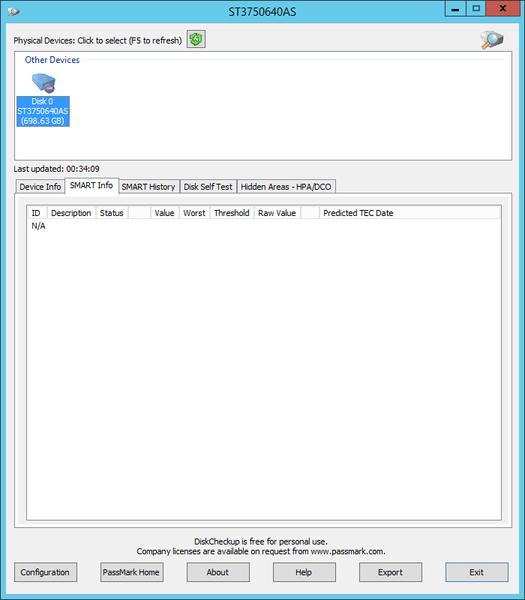

        • critical0
          • Dec 2015
          problem retrieving SMART data
          Having the same problem. DiskCheckup 3.3 build 1000
          CrystalDiskInfo is displaying SMART info correctly, DiskCheckup does not.
          I've been checking it against following setups:
          1) 1HDD
          2) 1HDD, + 2HDD in RAID 1
          Screenshot attached.
          I could not attach log file for DEBUGMODE, system gives me 'Invalid file' error on any attempt to upload .txt file.
          So I'll just list it:
          DiskCheckupLog.txt
