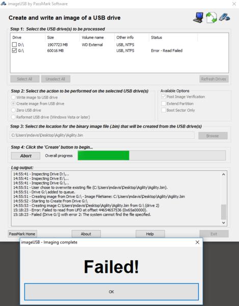

        Having a similar problem with a Kingston DataTravler G3 64GB drive.
        (If you want a new thread, let me know.)
        -Matt
          #19
          -Matt
          The error being reported is that imageUSB is failing to read from a specified address (0x65A00000) on the USB drive.
          Have you tried creating the image again? Is the error reproducible (and at the same offset)?
          You can also try to open the UFD with a raw disk viewer (e.g. OSForensics) and navigate to that position to verify the contents can be read.

            Yes I've tried several times. It seems to keep moving to another address. This last attemp reads "Failed to read from UFD at offset 44671434752 (0x66a00000)".
            Right before this error, I hear the Windows sound for disconnecting a removable device. And then it is re-detected as a Unknown Device. I have to remove it and re-insert it, then it's fine again.
            I was able to run WinZip to make a copy of all the data on the drive (System/Hidden incl). With no errors.
              • 11135
              #21
              Do you have another flash drive to test with. Could be a hardware fault (or a fake USB drive).
              (if it was a software bug, it is much more likely to always fail at the same offset).
