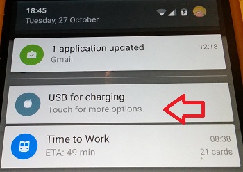

    STEP 1b) For Android V6: Google changed the process in V6 (Marshmallow). When the USB cable is connected this message appears in the notification area. It will say something like "USB for charging".
    Then after, touching for more options, you will see this window.
    Select the MTP option, if not already selected.
