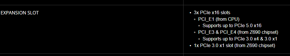

      This is mobo spec

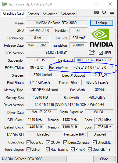

      Looking at GPU-z my GPU is only working at PCIe x4 3.0.
      I will try to test my GPU on other PCs.

          Most likely your GPU cannot run at full capacity since its connected to a PCIe 3.0 x4 slot.
          And if your motherboard's first PCIe slot cannot detect GPU, you probably should get it replaced.
