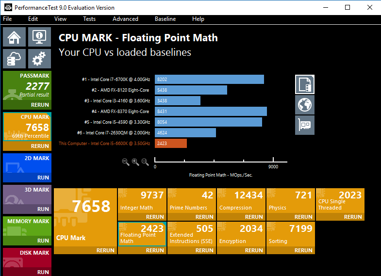

    Very low floating point math score.
    Hi!
    I get a very, very low score on the floating point. (~2450)
    An i3 is get higher results.
    I have an overclocked 6600k (45x102.25) ~4.6GHz.
    No temp or throttling problem.
    This cant have anything to do with my memory, because all the memory test gives me pretty high scores.
    I cannot for my life understand why i get so low score?
    Anyone have any idea?
    Running latest version as of October 11 and latest Windows 10.

      I tried optimized default in bios, i get around 200-300 points lower.
      As far as i can see cores are working 100%.
      Click image for larger version  Name:	passmark.png Views:	3 Size:	51.3 KB ID:	36099

          Yes, confirmed all cores 100%. And with my 4.6GHz o/c it hits around 4.5GHz.
          2398 points...

                Ok, i have now tried different settings in bios aswell as an optimized default.
                Regardless if i run the CPU @stock, @4.2GHz or @4.6GHz, i get pretty much the same score.
                It sits around 2300-2500 points.

                      1 core: ~1330
                      2 core: ~2280
                      3 core: ~2430
                      4 core: ~2480
                        So even running 1 core is slow.
                        Still looks like throttling, but that doesn't explain why only the floating point result is effected.
                        So a bit of a puzzle.
