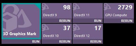

      when starting benchmark on start screen it also happen, that not all 3D tests will be done.
      most of the time the DX 11 test has no result

        when the DX11 test starts the screen go black/flickers and thats it, then the DX12 test is loaded and this one is working fine as well.
