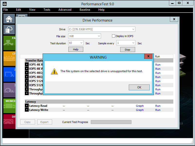

      Thanks for the reply David. I've poked around the advanced tests and even though it's file system is NTFS the Advanced Test tells me that it is unable to run because it can't read the C: drive's file system. All the other drives are NTFS as well and they can be read by the Advanced Test but they don't give me a benchmark score, just the stats of the drive. Any chance I can tweak the size of the test files in the Drive Benchmark test? Regards

            Thanks, we have added some more debugging to the advanced disk test in this build, http://passmark.com/ftp/temp/petst_debug.exe. Could you please generate another debug log and send it to us (there should also be a SysInfoLog.txt file created as well). Could you also please attach a screenshot of the exact error message you're seeing.

              Hi Tim, I installed the petst_debug.exe file onto the server but I can't tell if that .exe file overwrites the installed .exe file? Anyway I've run the test again and uploaded the log files and a screenshot of the error. Thsnkd for your help.
                Thanks for that, we had been focusing on the Advanced Drive Test dialog and not the Drive Performance (two separate groups of tests) so the screen shot sorted this out. It looks like a call to get the file system type has failed (GetVolumeInformation) at this point for some reason on your system.
                We have made some changes to default to assume NTFS in such a case so the test should continue. Could you please try this build and let us know how it goes, https://www.passmark.com/ftp/temp/petst_debug2.exe.

                  Hi Tim, Thanks very much for all your assistance. The petst_debug2.exe file worked so I'm now able to run the Drive performance test on the C: drive of the server in question. Thanks again!
