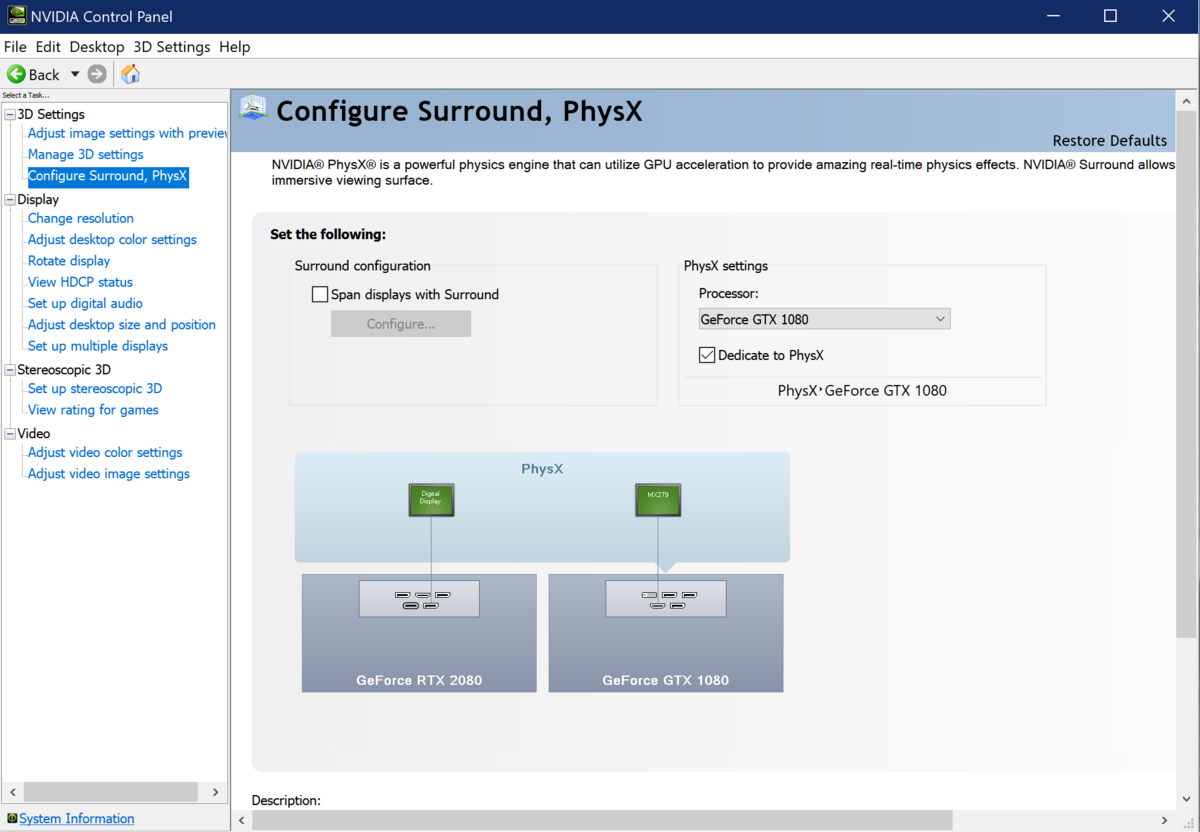

    Hi all, just purchased the software and I tested my PC. I have a GTX 1080 that is dedicated to PhysX and a RTX 2080 XC Ultra for everything else. When the 3D graphics portion came up, everything went okay except for the DirectX 12 portion. It used my GTX 1080 instead of my RTX 2080 gpu, so it scored lower there. I'm not sure why because it used the 2080 for all of the other tests. I tried setting OpenGL rendering to only the 2080 and the CUDA - GPUs setting to my 2080 under the program settings for the performance test in general as well as the DirectX12 program for it. Please help!

      It is dedicated to PhysX via NVIDIA settings. So during the graphics benchmark, it used the 2080 for all of the tests except for DirectX12. When it launches it shows that the 1080 is currently being used and at the end of the entire benchmark where I was about to upload it to the website it also said that the 1080 was being used on that one test. It's very peculiar, for sure.

          Yes I have my second monitor connected to the 1080 to save every bit of power from the 2080 as it is dedicated to my 4K monitor. So even though it is dedicated to PhysX it still powers only that monitor. I have even tried right clicking on the program and rendering OpenGL only on the 2080 but it still does not work correctly. I can try to remove the 1080 just for testing purposes but I still wonder why it runs all tests on the 2080 except the one that matters most, lol!!
          ***EDIT***
          I fixed the issue! I simply unplugged my second monitor from the 1080 and reran the DirectX12 test and it utilized the 2080. Thank you for trying, though!
