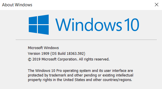

                        The error from the screenshot points to a missing DLL, likely the system doesn't have the Microsoft Visual C++ 2015 Redistributable package installed (https://www.microsoft.com/en-us/down....aspx?id=52685).
                        What version of Windows are you using?
                        • rofl
                          • Jul 2019
                          • 23
                          W10 1909
