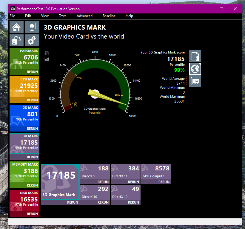

        I have been testing your Alpha Build V3 and my computer scores are much higher now vs build 1035. I'm curious as to how these Alpha Passmark scores will compare with Passmark V9. My CPU and NVME score is slightly lower in the Alpha build, but everything else is much higher... memory, 3D video, 2D video and the overall computer score. Unfortunately, I won't be able to use it much longer since my Passmark V9 key doesn't work with the Alpha version... only 7 days left.
        I also tried to upload the results of my testing, but it doesn't show a real link to the result.
        The biggest change is the 2D and 3D tests on my computer... the 3D test alone increased by over 5000 points vs Version 1035!
