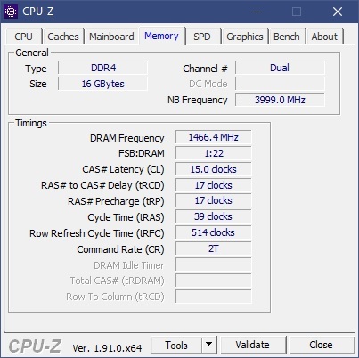

              Are you sure you RAM is in dual channel mode?
              • LeoLOST23
                • Jan 2020
                • 13
                Yes, its in dual channel. Im gonna try changing the ram to the other dimm slots and see what happens.
