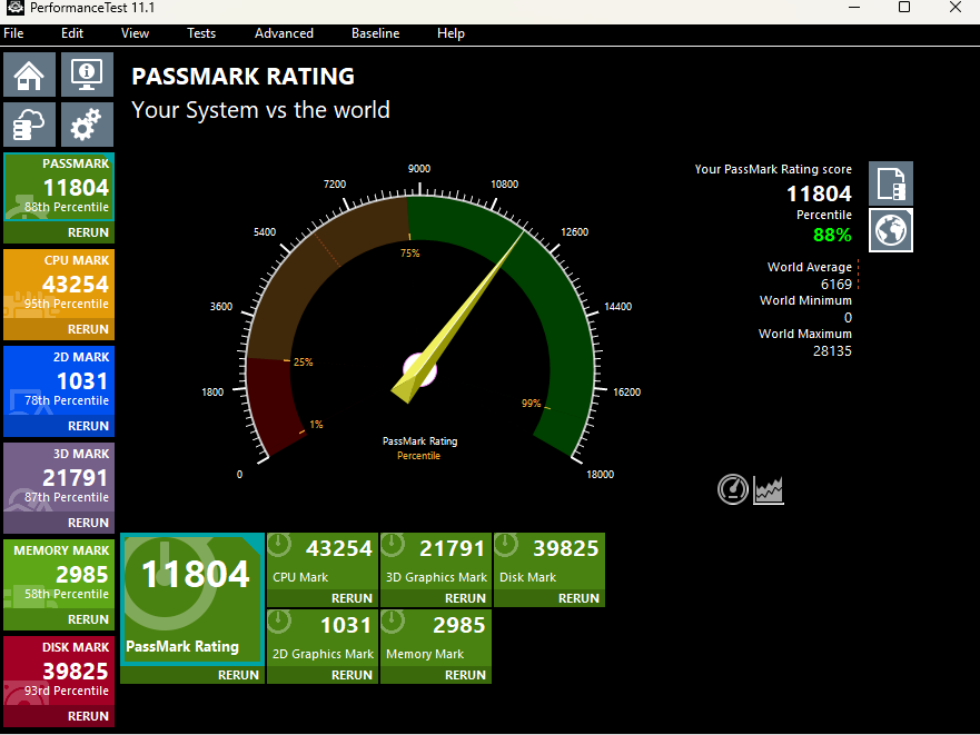

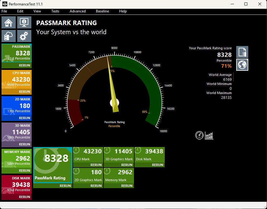

                          • apassi
                            • Sep 2026
                            Turning off G‑Sync and the monitor’s FreeSync didn’t help my poor 2D score. I also removed the second monitor, but that didn’t help. What did help was going into the NVIDIA Control Panel → Manage 3D settings and changing the power management mode from ‘Normal’ to ‘Prefer maximum performance’. My 2D score went from 200 → 1000 and the overall score from 8000 → 11000. If you leave that setting enabled, the GPU may run a bit hotter and use more power, if I’ve understood correctly.
ID:	60765 Click image for larger version

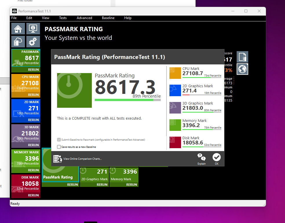

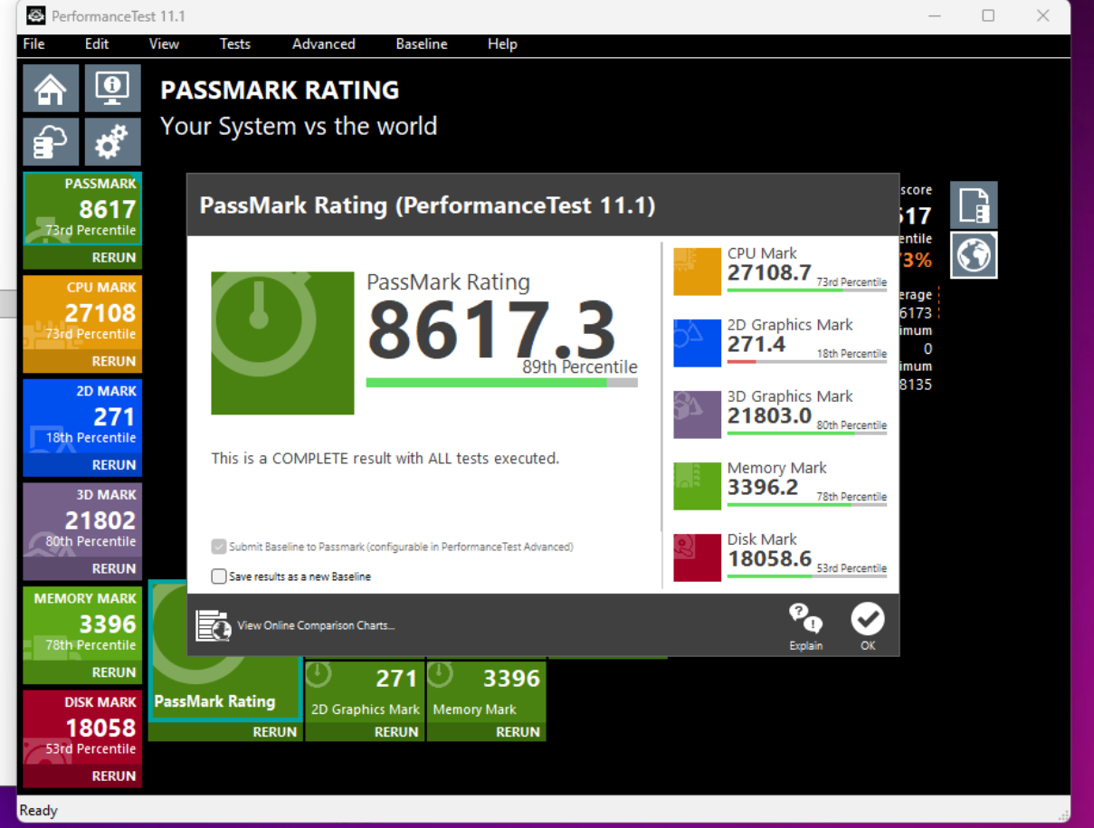

                            • Dilligas
                              • Sep 2026
                              Tried G-Syn off, and on, also max performance setting to on...still a horrible score.Click image for larger version
Name:	Screenshot 2026-09-22 203438.png
