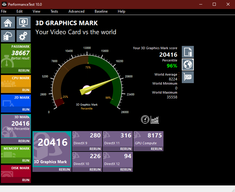

    I'm having issues with DX12 testing with the AMD Radeon RX 6900 XT.
    I'm only getting a score of 36
    My older RX 5700 XT got 94 score in DX12 in the same machine so I am at a bit of a loss as to how this new flagship card could perform so poorly in comparison.
    The overall GPU score is therefore stunted heavily, and the 3D Mark score is totalling 18,428.
    I have tried enabling BAR (SAM) and Rage mode but still the score I am getting is only 36.

    I've tried running a DDU in safe mode and re-installing the latest AMD drivers. Still the same results.
    and here is the best result on 3D Mark so far. DX10, DX11 seem ok, but DX12 is below the standard for performance. Granted, there aren't that many samples (I think I am only the 10th!) but I'd like to see if I can get it to where it needs to be.
    If true, this was very high. Maybe highest result for any RX 5700 XT ever.

        You are right about that performance though - very high in comparison the the rest. See pics from the 5700 XT run. I did it a few times and very similar results.
        Regardless of that, surely the 6900XT should be better in DX12 though, right?
