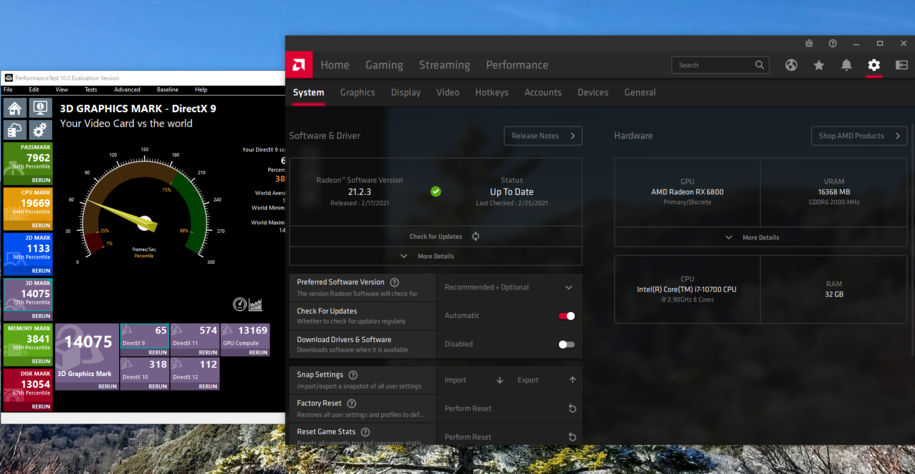

    Hi all,
    I recently purchased a RX 6800 and everything is working well except for Performance Test DX9. I am running PT version 10.0 / build 1011.
    Yes, DX9 result it should be higher.
    Are you using a monitor with FreeSync / G-Sync enabled?

      No, and the frame limiting / vsync settings are all disabled in the relevant settings areas.

        The AMD software shows ~85% GPU utilization while running the DX9 test.
          Yes, the other 3D test result appear to be fine. Or even slightly above average.
          Do you have any 3rd party video software installed. They cause all kinds of problems. e.g. screen sharing, video streaming, video recording, head up display / game overlays, remote desktop, etc...
          Tuning / overclocking apps can also sometimes cause a problem.

            No. The only software possibly impacting performance is the Radeon software.

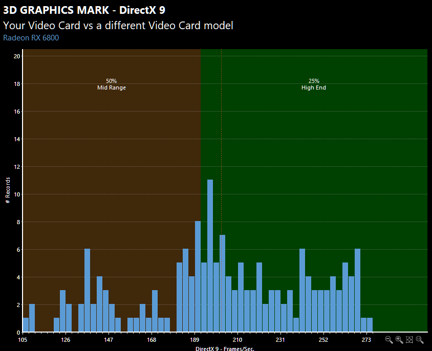

                The RX 6800 is an expensive card. We don't have one to test with. But the code for the DirectX 9 test is more than 10 year old now, and run on millions of machines. So very low chance of it being a software issue. Yes could be a driver issue. But we aren't in a position to debug AMD's driver or try different settings.
                It isn't a common problem. Here is the distribution of results for the RX 6800 card in this DX9 test. No one is getting results as low as yours. So very likely it is some local issue on your machine. Having said that the distribution is pretty broad. So obviously other factors, driver settings, CPU in use, cooling, monitor, etc... effect the result.

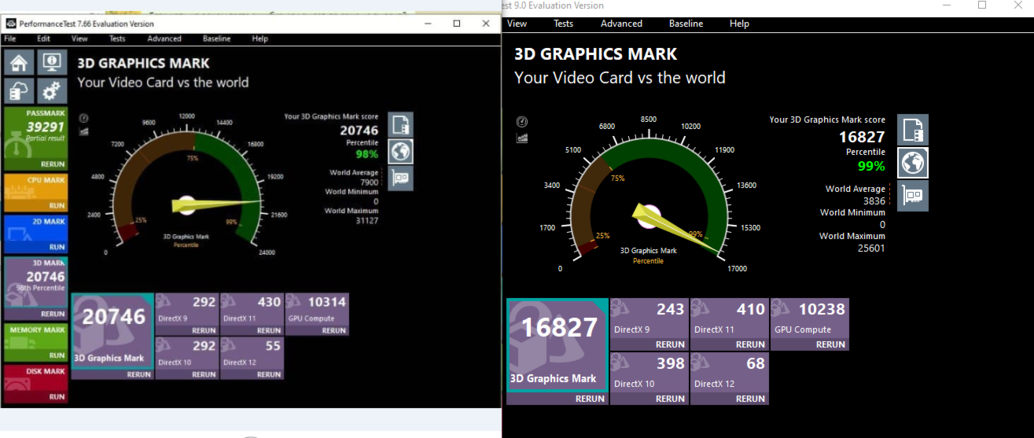

                      I have same problem with GTX 1080TI.
                      There is test that i did 20aug 2020 and today with last version:

                        But with clean install of 10.1 version its works right.
                        Try to delete all versions of perfomance test and install 10.1.

                          Kerosine, I think you were probably using a (poorly) hacked / cracked version of our software. I am guessing you got it from some dodgy Russian download site. In addition to the benchmark results being wrong, these hackers sometimes insert viruses and backdoors into the software.
                          Getting the software from our site (with valid code signing signature) avoids this.

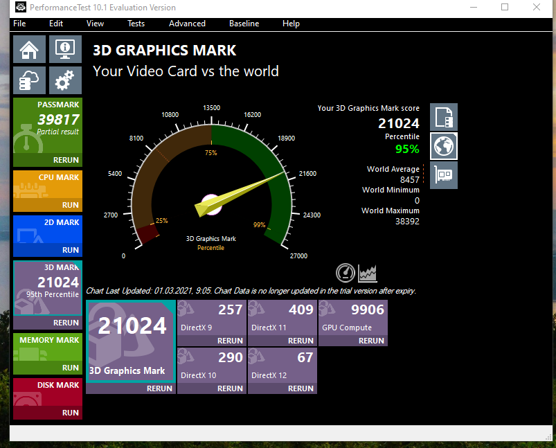

                            I'm having the same issue with my RX6800. I actually tested it on a different pc and it scored 22000 then I swapped it into a new hp omen that I got and it's getting terrible dx9 scores.
                            It's not the program because I tested the 3060 ti that came with the omen and it scored 22000 with a dx9 score of 253. The rx6800 is getting 50s and 60s.
                            • Somanymods
                              • Jun 2021
                              So apparently turning on Radeon antilag in the amd software fixes the frame rate. Not really sure why. I apologize for the sound in the videos, 2 year old twins and a 6 year old, you may want to mute.
