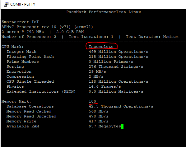

    I ran pt_linux_arm32 for performance testing, chose Processes--1, iterations--1, duration--1 as following pictures shows, few questions
    --how long time will be taking for running for extended instructions? I kept it running over night still shows running progressing.
    --is there any way to skip the process?
    --or any further configuration needed for running?
    thanks.

              Progress currently, the NEON process went through. debug.log attached.
              the CPU Mark show incomplete. any reason or should keep it running longer? thanks.
