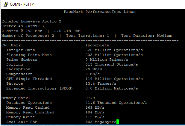

          #19
          Thanks for new version trying, looks CPU Mark still Incomplete as attached.

            #20
            Thought that would have fixed the problem.
            Could you upload the "debug.log" file from that build?
