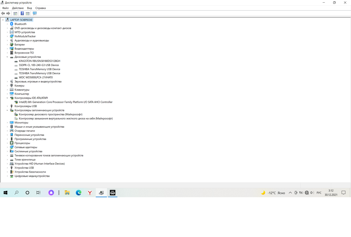

    There are two moments that cannot be eliminated.

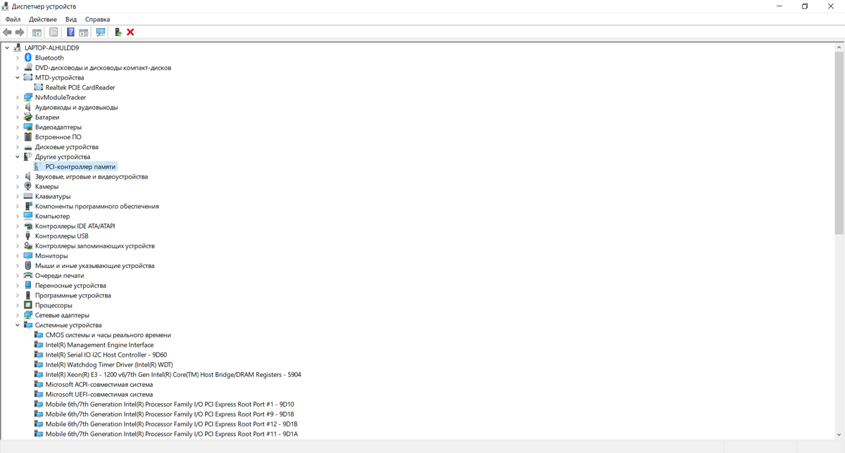

    After reinstalling, the OS has a question mark device - PCI memory controller.
    ID
    PCI\VEN_8086&DEV_9D20&SUBSYS_00000000&REV_21
    (has not an exclamation point, but a question mark)
    The description says:
    "This device is not currently connected to your computer. (Code 45)
    To resolve this issue, connect your device to your computer. "
    If I delete a device, it appears with an exclamation point.
    Installed all the drivers of the manufacturer and also DCH driver through Intel Support Assistant.
    Maybe this is not a significant moment. Because all devices are installed in Device Manager.

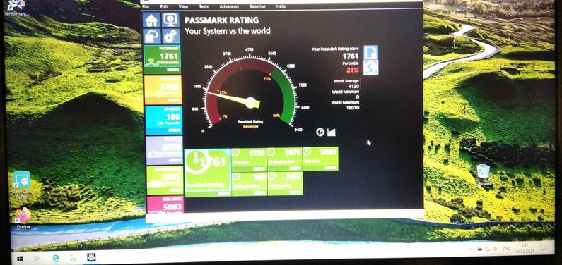

    Also, after reinstall OS, passmark test readings fell
    15% less processor performance.
    50 percent less performance 2D graphics.

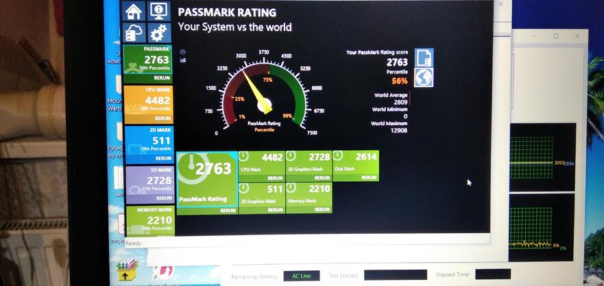

      When I run testing from the old ssd (I saved it with the OS), then the performance is normal!
      With uefi version 1.47....
      Acer technical support told me that because of the vulnerability patch, there can be no big drop in performance. Like for 2D test.
      Here are two screenshots. Old OS and new. There is a difference. Help me understand what's going on? Why the testmark test can respond.

        So they showed the old OS (the bigest) and the new OS.

          Reinstalled all drivers and the question mark device is gone.
