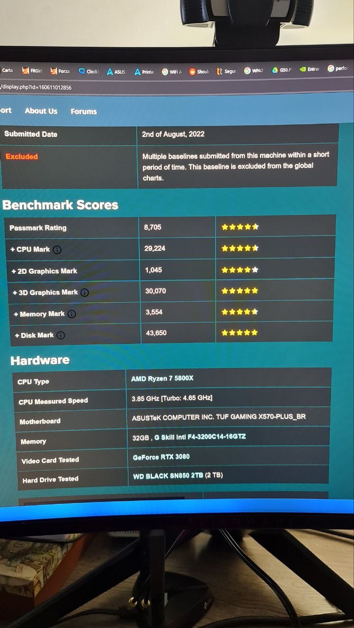

Stock RTX 3080 with score higher than RTX 3090
  • Dariojc
    • Aug 2022
    How is that possible?
  • Dariojc
    • Aug 2022
    Best than GeForce RTX 3090 Ti(29953)
    • SangreAzul
      • Aug 2022
      I think is because this chart is from months ago with old PerformanceTest version.
      I got also on my RTX 3080, 29400 GPU score and in the chart the 3080 its around 25000.
        • 11114
        Here is the distribution of 3DMark results for the 3080 video card.
        Getting a result of around 30,000 isn't that unusual. It just means it is a nicely optimised system. And it also the case that not all systems are so nicely optimised. It is fairly easy to have slow 3D (bad cooling, wrong PCIe slots, weak CPU, slow RAM, frame rate limited due to monitor, device driver variations, background bloatware, etc...)
        It is not related to the "age" of the chart as we update the chart every few days with new results.
