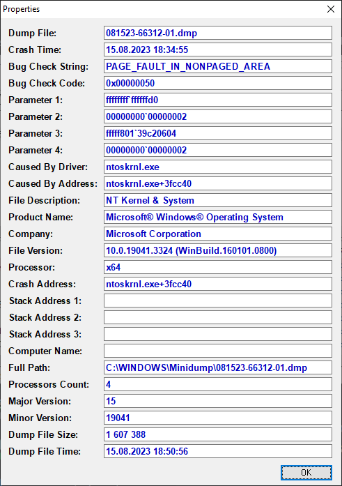

    Here's more info with blue screen view. Hardware is a 2017 iMac 21,5 inch with the latest GPU drivers installed

          Sadly Nirsoft's BSOD viewer does not give me anything useful about the cause other than it being caused by ntoskrnl.exe
            ntoskrnl is the Window kernel.
            I did some Googleing for you. Seems there are 100,000s of posts of people complaining about BSOD on Mac hardware with Bootcamp. Again it is likely device driver related or a hardware failure. You could try removing all peripherals and see if it helps.
