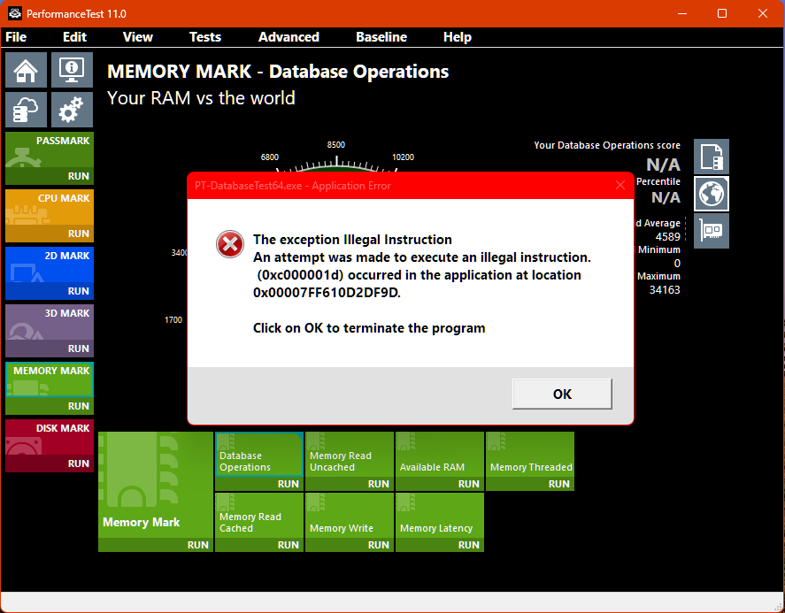

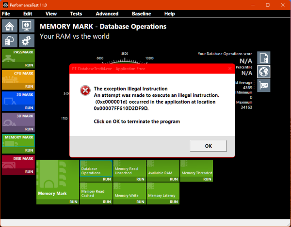

    Everytime I try to run the Database Operations in Performance Test 11.0 latest version. Build 1014 it fails to run. Seem to get 2 or 3 different reasons why. Mostly its says can't write to some darn area ....Had this issue before and I posted a fix for it on Feb 6th 2024 ....but I don't find my post on here anymore showing how I fixed it. ??? I made a change in my bios settings, and posted how I fixed it on here, but that post seems to have been removed. ?? I have same problem now again.
    Mike ....
    Here is a screenshot ...

        Just going to add the text of the error here to make is easier to search for in the future
        The Exception illegal instruction
        A attempt was made to execute an illegal instruction
        0xC000001D
        This isn't an error we have come across before in this context. This type of error would typically occur when running modern code on an old CPU. The modern code would contain some new low level machine code instructions (like SIMD code) that the old CPU couldn't execute. Leading to this type of crash. But in this case your CPU is brand new. So this isn't the cause here.
        So more likely the hardware isn't stable and you have data corruption. This would also explain getting several different error messages. These new i9 chips are being pushed to far in terms of clock speeds and power usage. So unfortunately they now have a reputation for being unstable. See also these comments from Intel regarding BIOS settings.

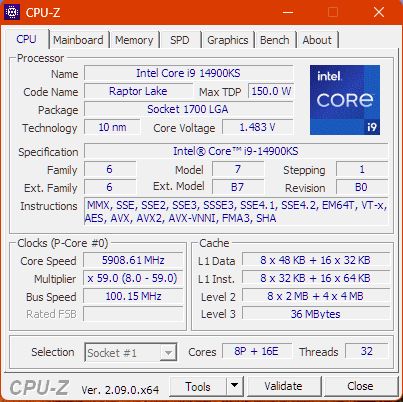

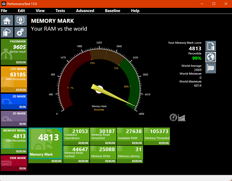

          Well this motherboard by ASUS is made to do only one thing ....its made for overclocking. Its only motherboard made by ASUS for overclocking. I was in my bios this morning and tried a couple changes. At least one of them seems to have worked David. I do not have any data corruption at all. When I get that darn error msg in the past its because I made a change in my bios and that affected the Database Operations in Performance Test 11.0. But because I tweak my bios a lot sometimes, I make bios backups Got them stored on a USB stick, don't store them in the bios. Bios updates will delete any backups stored IN the bios. I've been on computers now for about the last 40 years, way before the internet. I love computers. I build my own, got two custom built pc's. Anyhow ....right now David I got it working again. Only made 2 changes in bios. (so far) Going to send you a screenshot I took this morning. Knew it was a bios setting that was causing the error ...just didn't know which one. My Intel chip is running at 59MHz but has since I installed it.
          Click image for larger version  Name:	Database2.png Views:	0 Size:	81.4 KB ID:	57109
            ASUS has two whole ranges of gaming motherboards that support overclocking (ROG & TUF Gaming).
            I can't think of any other explanation for the errors.
            A typo I assume.
            The i9-14900KS should run at up to 6.2Ghz.
