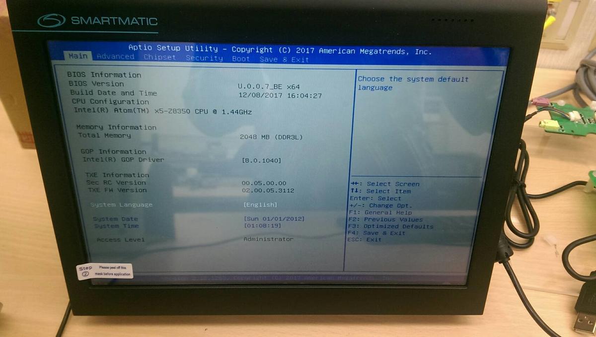

          Dear David ,
          Thanks for the response .
          Below image is the HW spec.
          Would you mind to give me a suggestion about which version of software that I should use in the flash drive ?
          Best Wishes
          Joshua
            The screen shot shows the CPU model, Atom X5-8350, which is about a year old. But it also shows old looking BIOS (not UEFI, which has been almost standard for 5+ years).
            It doesn't tell me anything about the rest of the system. e.g. sound card, motherboard, disk, network, etc...
            Can this machine boot Linux (any flavor of Linux)?
            I would start by upgrading the Flash drive to the latest software and try that.

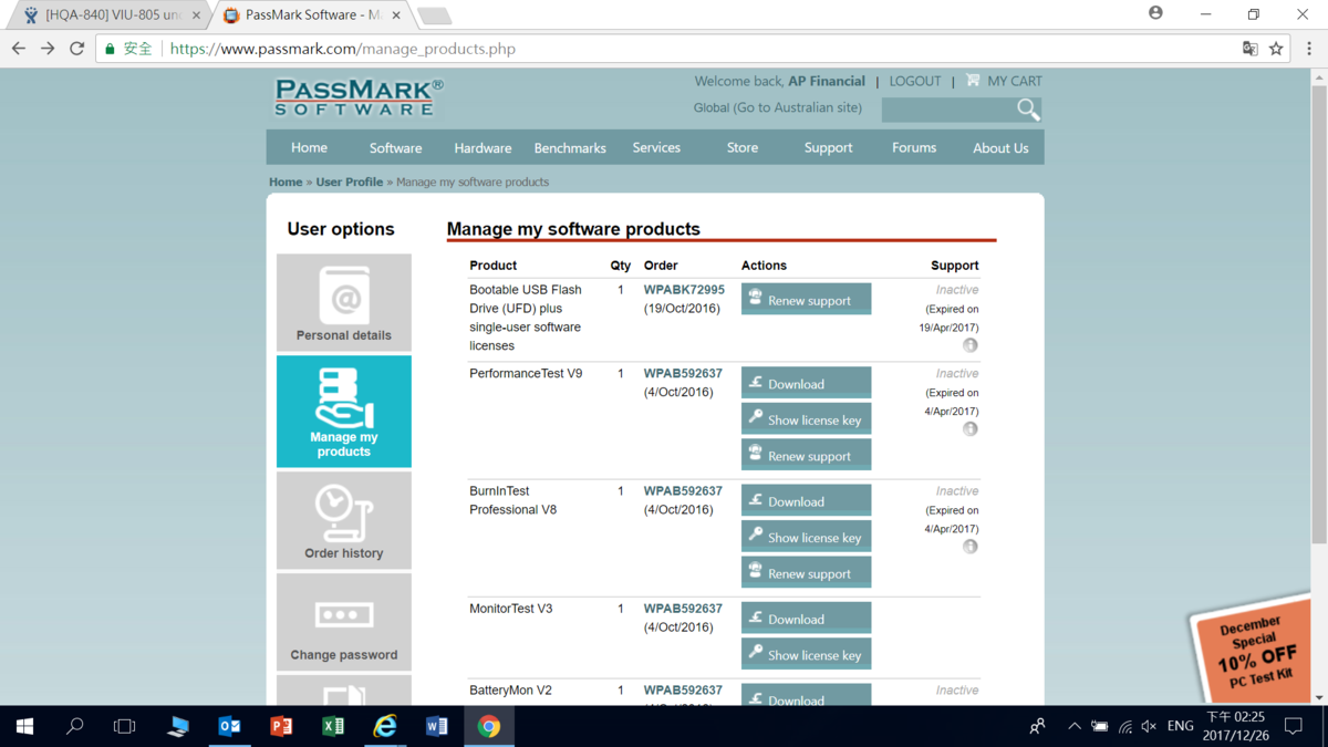

              Yes , we have tried to use our own Flash driver and this machine could boot in to Linux system without a problem.
              I could not find the software file to download for the Flash driver updated in PASSMARK website.
              Is it because our SW support has expired ?
Name:	SW support expired.png
              Best Wishes
              Joshua
                Yes, it expired in April 2017.
