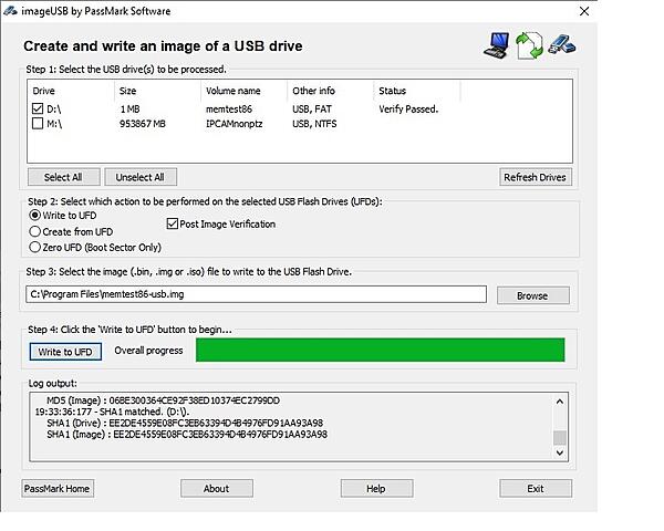

                  I'm having a similar problem - as title of topic.
                  Oldish HP Compaq Windows10Pro with BIOS, not UEFI.
                  Downloaded memtest86-4.3.7-usb.img
                  Running the imageUSB application, the only Windows file copied to my (empty) 2Gb USB drive is memtest86-src.tar.gz in folder src
                  The .img selected is not copied. Any suggestions?

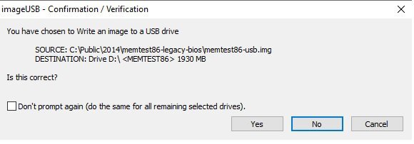

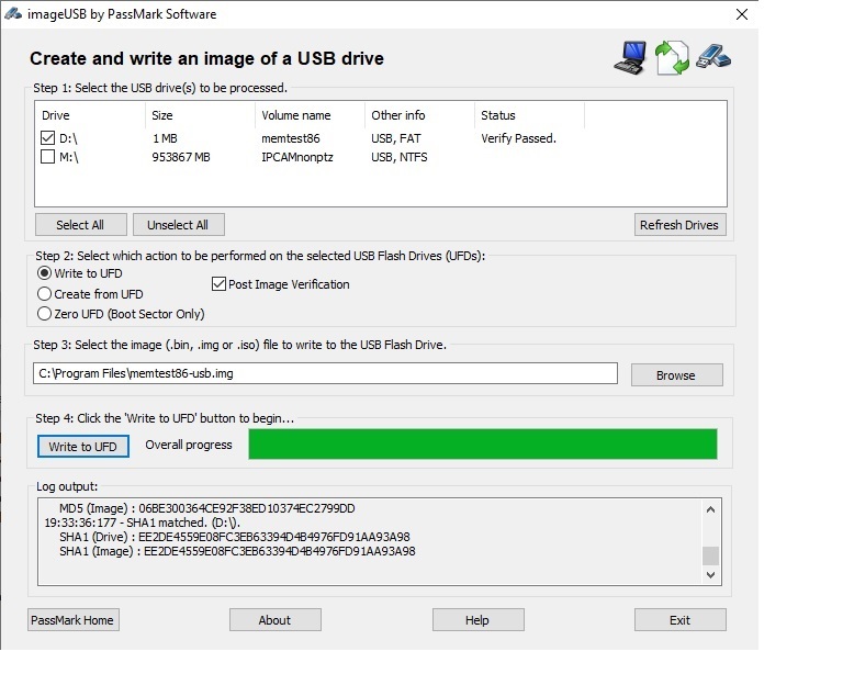

                      Well, I used Windows to reformat the pen drive (unticked the quick option) then checked it with h2testw. It showed 1.89Gb
                      Running the imageUSB again I get the same result. The only folders/files copied are src, syslinux and the PDF guide.
                      Windows Disk Management shows Capacity as only 1Mb. Selecting Format again it returns to capacity 1.88Gb, 100% Free.
                      Again running imageUSB (as administrator) it shows drive D as 1930 MB. That selected, Write to UFD selected, memtest86-usb.img selected
                      Refreshing Windows Disk Management, it once again shows D drive with capacity 1 Mb
                      Any ideas what's going on?
                      Barry
                        Maybe you are confused. The .IMG file doesn't get copied to the USB drive as a .IMG file.
                        The .IMG file is a complete copy of a USB drive. (a so called disk image).
                        So after copying the content of the .IMG file to the USB drive you won't see a .IMG file you will see the cloned content of the original USB drive (in the case of V4 of MemTest86 these are folders like src, syslinux and the PDF guide).
                        So did you test the USB drive by booting it? Maybe it is working.
