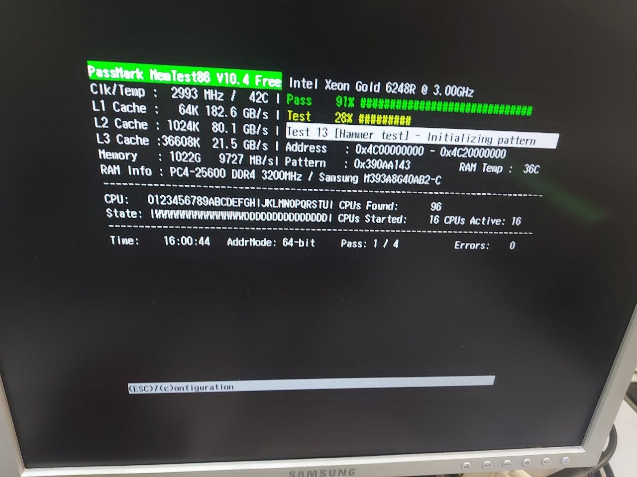

                  Hi! I have a similar problem,
                  Sysinfo:
                  CPU: 2x intel Xeon Gold 6248R
                  RAM: DDR4 16x64Gb Samsung M393A8G40AB2-C (3200MHz), but motherboard supported 2933MHz
                  I'm attaching the photo and logs​.
                  Thank you!
                    Rudolf​, your issue seems to be unrelated to the initial post. (i.e. it doesn't seem to be related to the Ram benchmark function).
                    So it might be a real hardware failure.
                    ​​​​​​​We'll take a look at the log.

                      The logs don't seem to be consistent with what is shown in the screenshot. As the logs indicate it is in the middle of test #4 but the screenshot is showing that it is running test 13.
                      Also, the logs indicate that the system is testing 1TB RAM in round robin (ie. single threaded mode). This will take an especially long time to execute.
                      Has the UI froze or is it just taking a long time?
                      Have you tried running in parallel (ie. multi-threaded mode) for quicker execution?
                        Sorry these are logs from another identical server, attached the correct logs​.
                          UI froze, did not try to run in parallel​.
                            Thanks for the logs.
                            Can you try running Test 13 by itself and see if the issue still occurs.
                            We are also looking at reducing the test time for Test 13 especially for systems with large amount of RAM.
