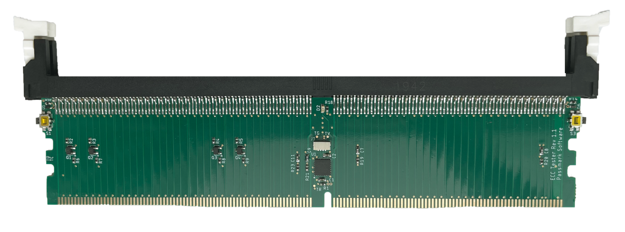

            FYI: We've got an ECC Tester interposer that can safely test DDR4 ECC RAM.
