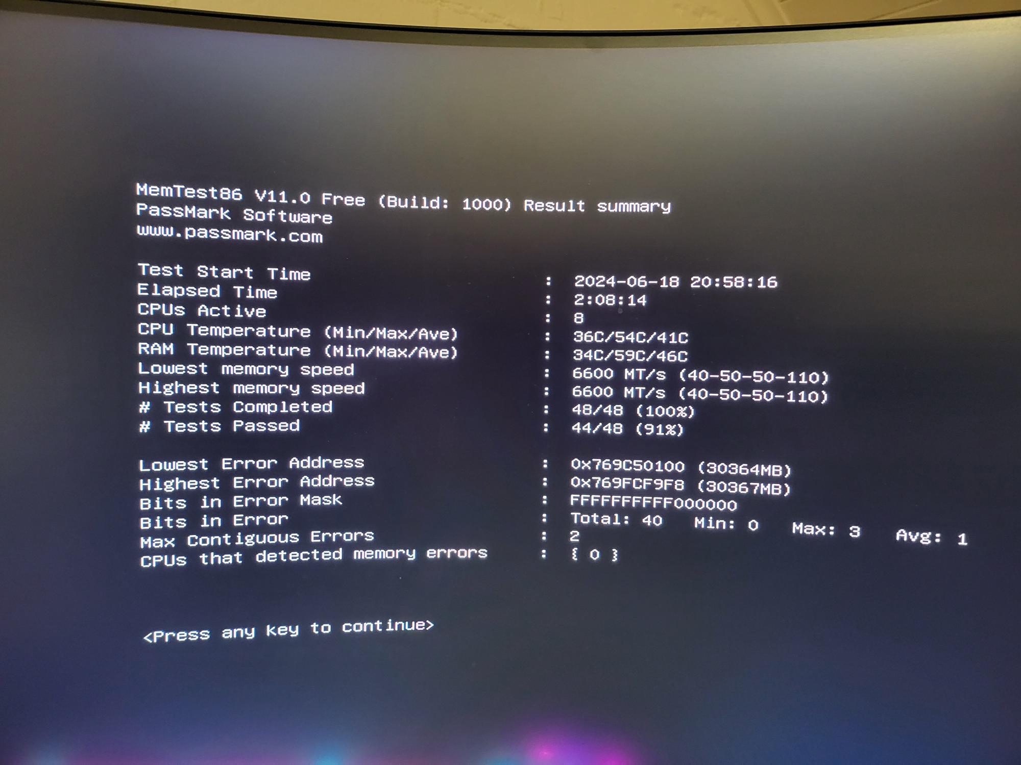

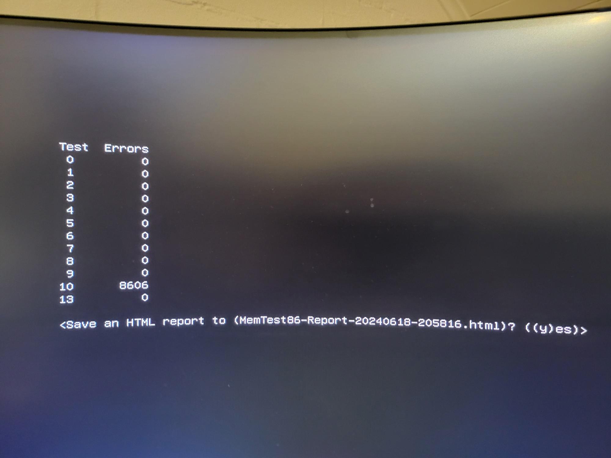

                          • bumkinkiller
                            • Jun 2024
                            #28
                            Same issues here. Z790. Corsair ram. Upgraded everything except power supply and video card.
                            Games keep crashing and sometimes bluescreen.
                            Memtest showed lots of errors at test 10.
                            Any brand people recommend to replace with?
                              #29
                              bumkinkiller​,
                              You could try direct message to CorsairJake​ above (he is Corsair employee). Should be able to get them exchanged for free, maybe.
                              • bumkinkiller
                                • Jun 2024
                                #30
                                Thanks David (PassMark).
                                I tried testing each stick individually. One passed all tests no problems and the other failed to post at all.
                                So pretty sure I just have one dodgey stick rather than an incompatibility error.
                                Will take back to Umart here in Sydney Aus for a warranty replacement.
