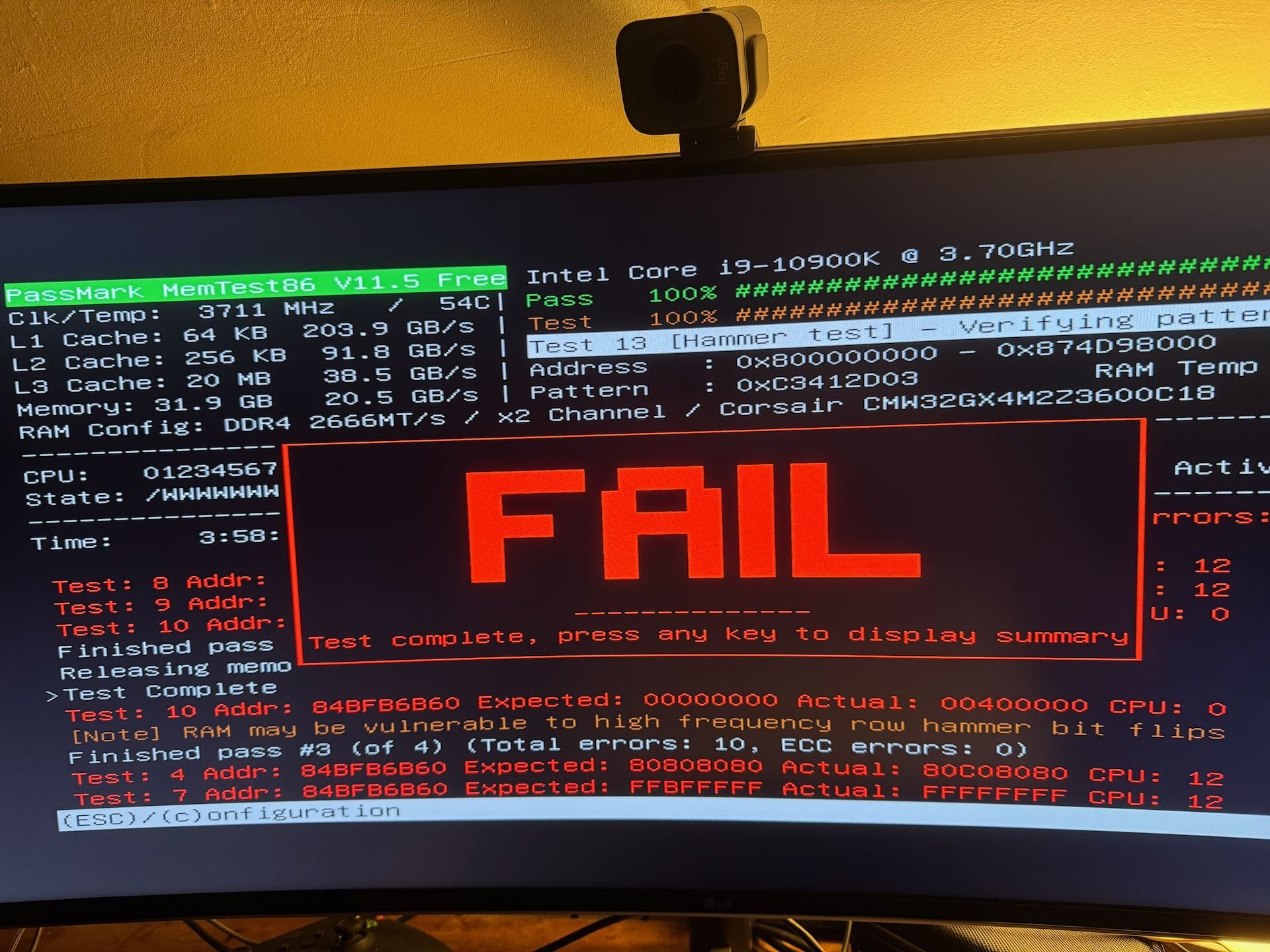

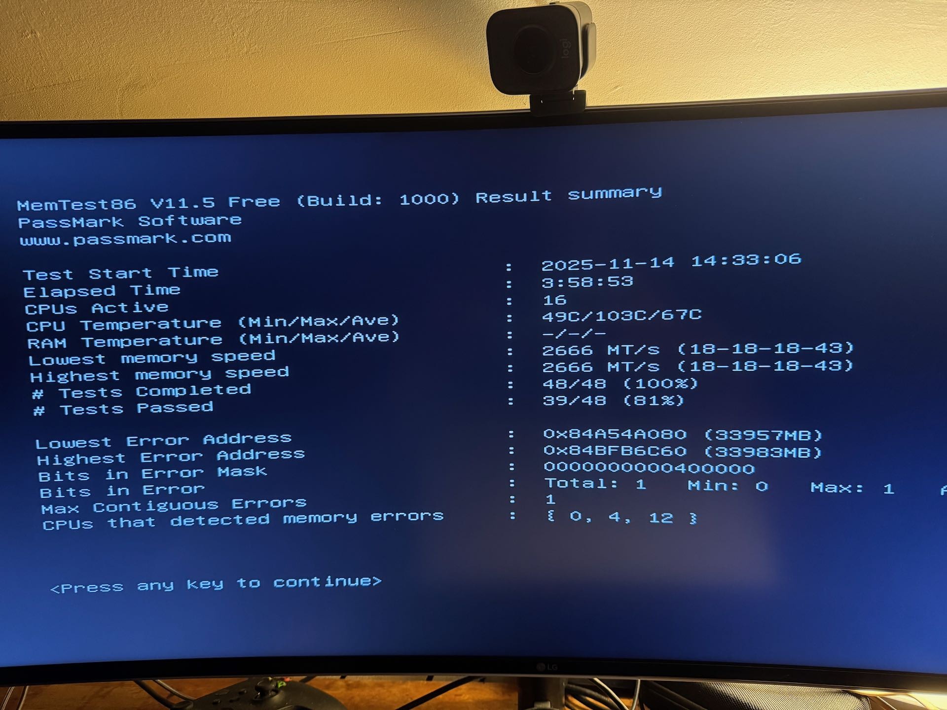

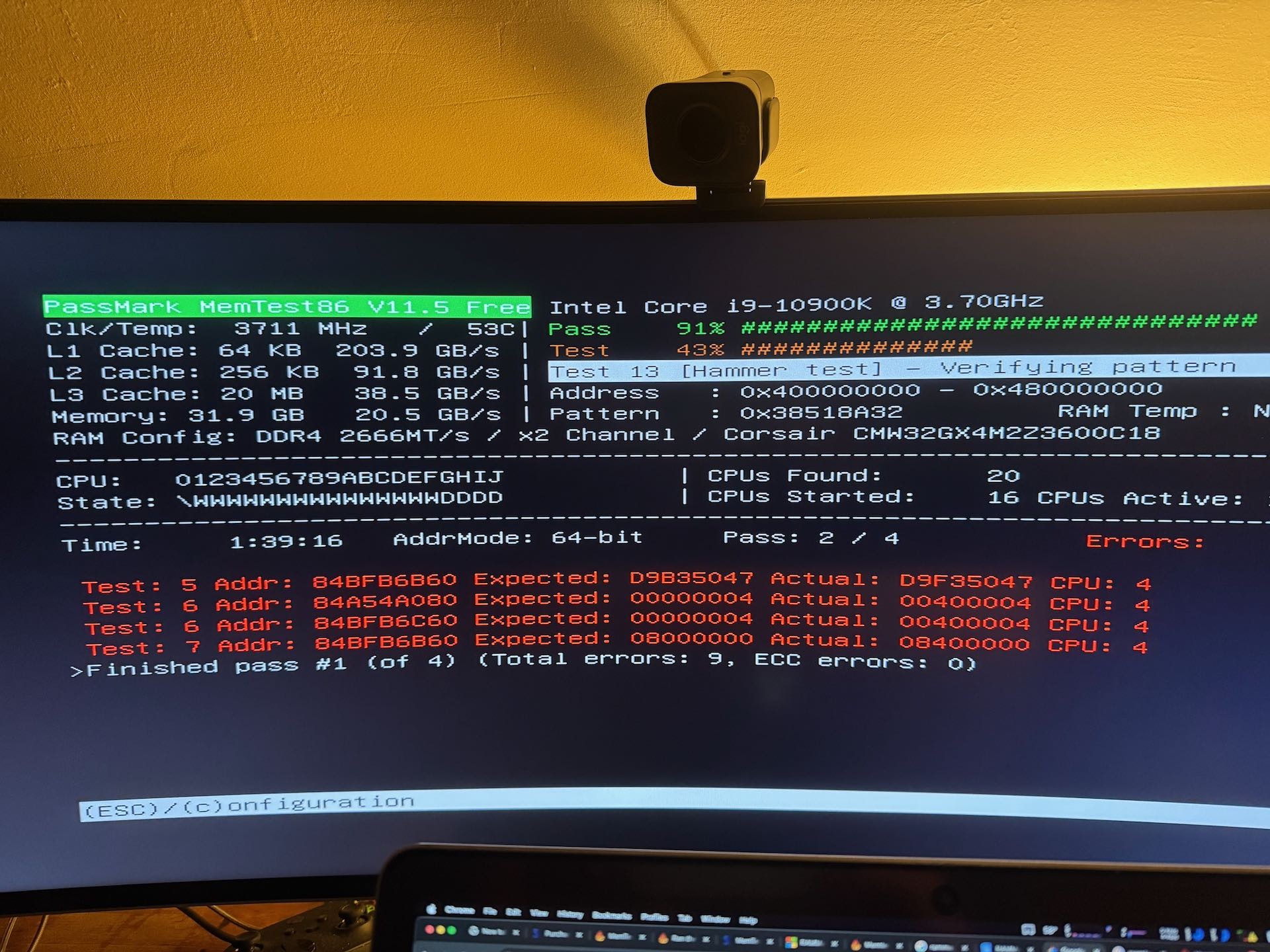

              #36
              Just to add to the list.
              Same kind of issue with DDR4 PC3600 Corsair CMW32GX4M2Z3600C18 (2x16Go)
              ​System (win11 - Azrockz490 TB3 - i9 10900K - 6800XT) can boot and run fine on light task but freeze on heavy load.
              Specifically during game development (unity + vscode + airLink) which threw me off chasing driver conflict, libray version etc... instead of testing for harware issues.
              Wasted so much time.
              Could not find the receipt for it so no help from Corsair...
              Won't buy Corsair again!

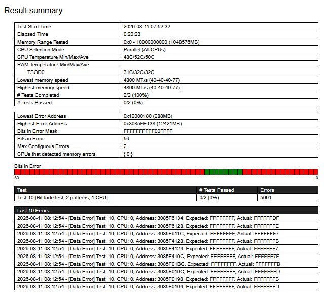

                #37
                Hi all, I am so glad I found this.
                Just for context I live in Hungary, I have the same issue with a DDR5 32 GB Corsair (2x16) - CMK32GX5M2E6200C36
                • Board: Gigabyte B650 GAMING X AX V2
                • Processor: AMD Ryzen 5 7600X 6-Core
                Considering the other posts, I ran the following tests:
                1. Full test - 4 passes: Test 10 error on each pass
                2. Test 9 and 10 - 2 passes: Test 10 error on both
                3. Test 10 - 2 passes: Test 10 error on both
                4. Test 10 - 2 passes - Ram stick A alone in slot 3: No error
                5. Test 10 - 2 passes - Ram stick B alone in slot 3: Test 10 error on both
                So I think is fair to say one of my sticks is consistently wrong, and I have to weight my options given current RAM prices.
                This is the summary of the last test:
                Result summary
                Test Start Time 2026-08-11 07:52:32
                Elapsed Time 0:20:23
                Memory Range Tested 0x0 - 10000000000 (1048576MB)
                CPU Temperature Min/Max/Ave 48C/52C/50C
                RAM Temperature Min/Max/Ave
                TSOD0 31C/32C/32C
                Lowest memory speed 4800 MT/s (40-40-40-77)
                Highest memory speed 4800 MT/s (40-40-40-77)
                # Tests Completed 2/2 (100%)
                # Tests Passed 0/2 (0%)
                Lowest Error Address 0x12000180 (288MB)
                Highest Error Address 0x3085FE138 (12421MB)
                Bits in Error Mask FFFFFFFFFF00FFFF
                Bits in Error 56
                Max Contiguous Errors 2
                CPUs that detected memory errors { 0 }
                Bits in Error
                x x x x x x x x x x x x x x x x x x x x x x x x x x x x x x x x x x x x x x x x . . . . . . . . x x x x x x x x x x x x x x x x
                63 0
                Test # Tests Passed Errors
                Test 10 [Bit fade test, 2 patterns, 1 CPU] 0/2 (0%) 5991
                Last 10 Errors
                2026-08-11 08:12:54 - [Data Error] Test: 10, CPU: 0, Address: 3085F6134, Expected: FFFFFFFF, Actual: FFFFFFDF
                2026-08-11 08:12:54 - [Data Error] Test: 10, CPU: 0, Address: 3085F6128, Expected: FFFFFFFF, Actual: FFFFFFFE
                2026-08-11 08:12:54 - [Data Error] Test: 10, CPU: 0, Address: 3085F611C, Expected: FFFFFFFF, Actual: FFFFFFF7
                2026-08-11 08:12:54 - [Data Error] Test: 10, CPU: 0, Address: 3085F4128, Expected: FFFFFFFF, Actual: FFFFFFFB
                2026-08-11 08:12:54 - [Data Error] Test: 10, CPU: 0, Address: 3085F4124, Expected: FFFFFFFF, Actual: FFFFFFF7
                2026-08-11 08:12:54 - [Data Error] Test: 10, CPU: 0, Address: 3085F410C, Expected: FFFFFFFF, Actual: FFFFFF7F
                2026-08-11 08:12:54 - [Data Error] Test: 10, CPU: 0, Address: 3085F01BC, Expected: FFFFFFFF, Actual: FFFFFFFB
                2026-08-11 08:12:54 - [Data Error] Test: 10, CPU: 0, Address: 3085F019C, Expected: FFFFFFFF, Actual: FFFFFFFD
                2026-08-11 08:12:54 - [Data Error] Test: 10, CPU: 0, Address: 3085F0198, Expected: FFFFFFFF, Actual: FFFFFFFB
                2026-08-11 08:12:54 - [Data Error] Test: 10, CPU: 0, Address: 3085F0194, Expected: FFFFFFFF, Actual: FFFFFFFD
