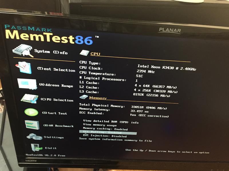

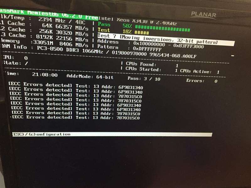

                          I'm a bit confused by the hammer-testing, it doesn't seem to be a straightforward test. Do these results indicate a pass or a fail?
ID:	34957Click image for larger version
                            Mike,
                            Read this information on the hammer test to start with.
                            Basically, there was an memory error, but your error correcting ECC RAM detected it and corrected it. So it would have been a 1 bit error.
                            If it was a 2bit or greater error, the ECC ram could not have fixed it and MemTest86 would have reported a warning or error as the value in RAM would have been corrupted.
                            So it was a fail, that the ECC ram turned into a pass. Unless you consider corrected errors to be a fail. It is a matter of opinion and how much risk you want to take on.
                            • mike@arnoldgauge.com
                              • Dec 2015
                              Thanks for the info!
                              I'll at least identify and likely discard the offending chip. If it was a workstation I wouldn't care, but this is a FreeNAS server and I'd rather not deal with an outage or potential data corruption.
                              The link was helpful, but I do have a quick follow-up question. I understand the ECC will identify and correct single-bit errors. The OS (FreeBSD in my case) won't be negatively affected.
                              What happens in a two-bit error? I understand the error can't be corrected, but does the server detect the error and notify the OS to retry and/or fail gracefully?
