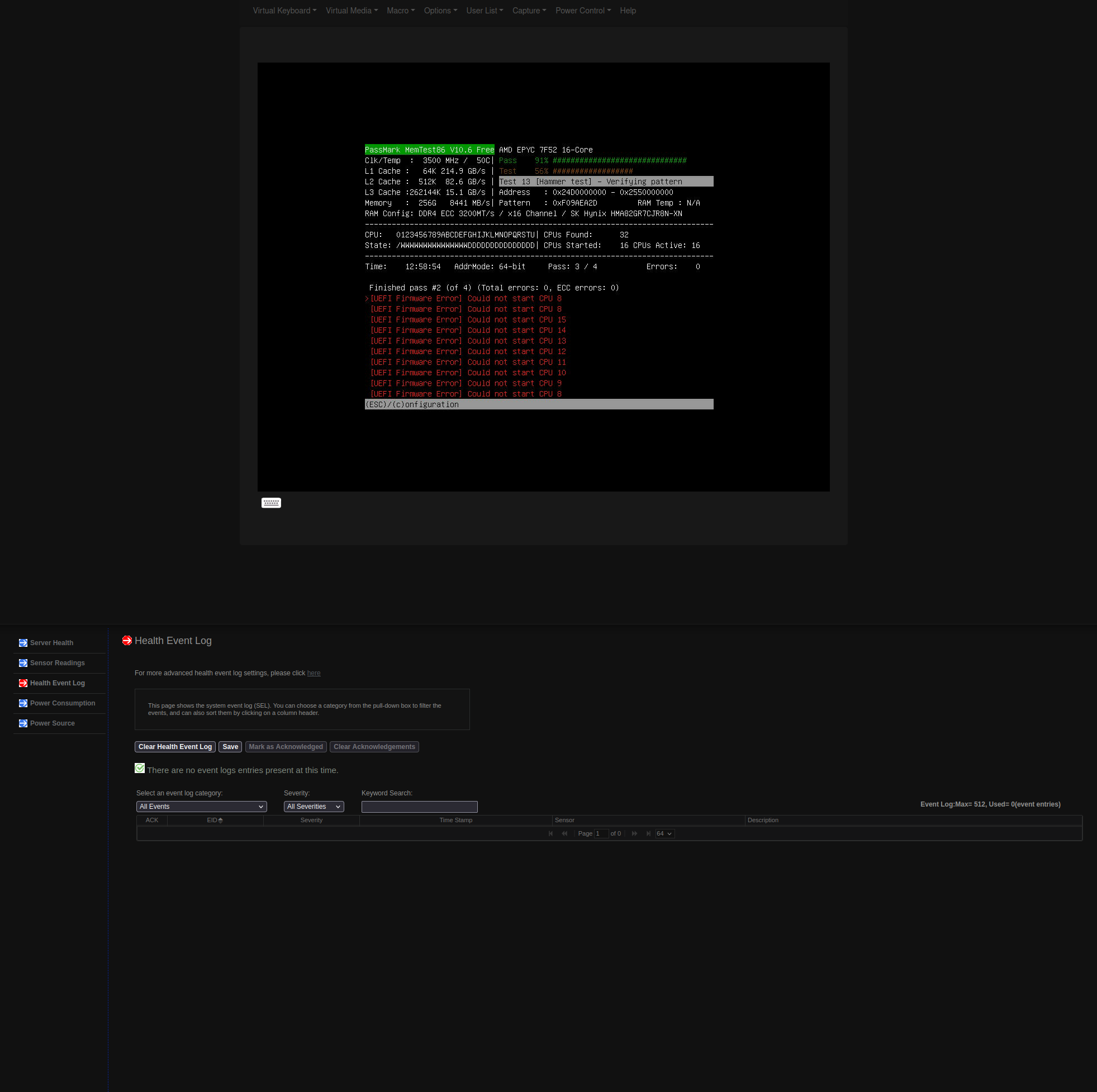

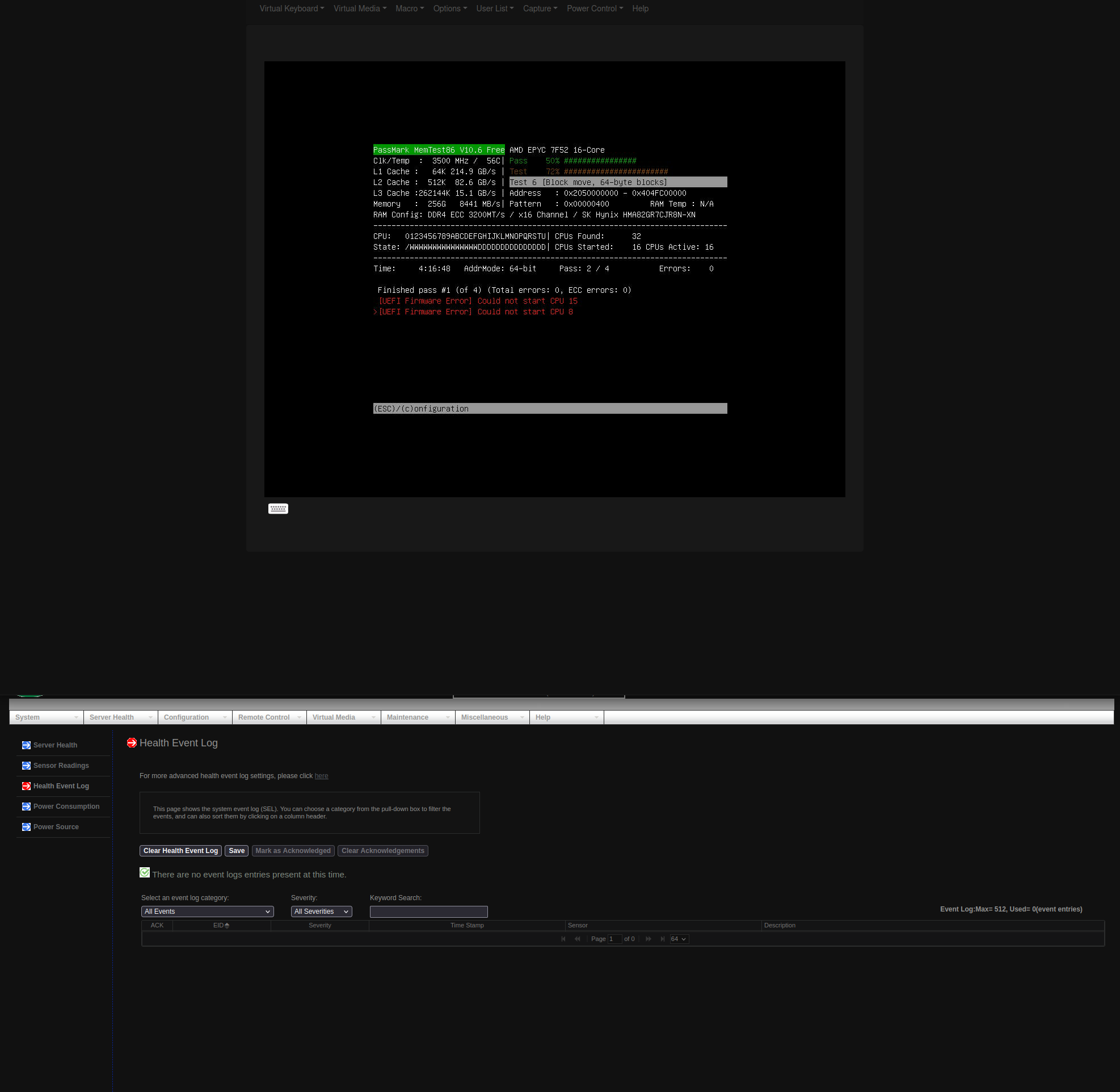

                      Motherboard: Super Micro H11DSi-NT
                      CPU: Dual AMD EPYC 7F52
                      BIOS Firmware Version: 2.5
                      No freezing or reboot, the software keeps showing the "[UEFI firmware Error] Could not start CPU X" message.
                      Super Micro just release a new BIOS version 2.7 recently, so the issue may be fixed?
                      • mt04340434
                        • Nov 2023
                        #146
                        Sorry admin for the previous post, I thought I can edit it after it is posted.
                        My motherboard BIOS FW is now updated to its newest release version 2.7, but the problem is still the same.
                        My test environment can be sum up as follow
                        BIOS Firmware Version: 2.7​
                        RAM: 16 x Hynix HMA82GR7CJR8N-XN DDR4 16 GB 3200 MHz RDIMM
                        Memtest86 Version: V10.6 Free
                        SMT is disabled in the BIOS
                        A retired 2U Super Micro Super Chassis with a 700 W hot-swappable power supply
                        I manually terminated the test after it finish pass #2, and the log file is attached.
                        As you may see in the attached log file, my current PC build can run the test without any error or warning messages (including the annoying "[UEFI brah brah brah"one) in the 1st pass. However, the "[UEFI firmware Error] Could not start CPU X" message will shows up after the 1st pass is finished.Before the test is aborted, the system shows no memory errors but I get loads of "[UEFI firmware Error] Could not start CPU X" messages during the test.
                        In fact, when I run the test with BIOS version 2.5, the system can do a 4 pass test with 0 memory error, and again, I just get so many "[UEFI firmware Error] Could not start CPU X" messages at the end of the test as you may see in my previous post.
                        The IPMI's Health Event Log shows no event of anything fail( I cleared it before the post tested is conducted, because I got loads of fan falling Messages when I pull out the high speed 8cm fans at night)
                        I also run the AIDA64 test (CPUs, cache & memory) for 3 hours to test the stability of my build. After the test is aborted, I don't have any reported errors from windows or the IPMI's health Event Log.
                        Am I likely experiencing the same BIOS bug that the other users mentioned in this thread?
                        Sorry for my broken English, please let me know if there is any other info that I may be able to provide.

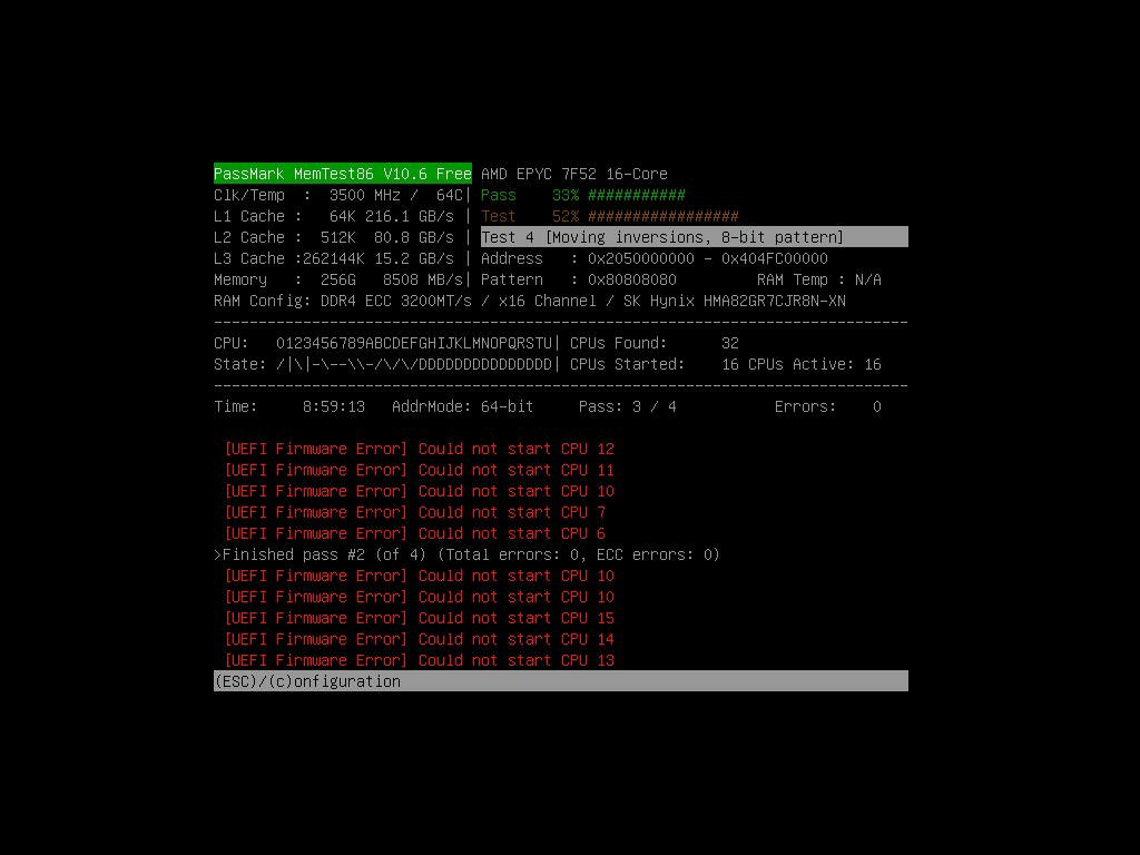

                          #147
                          Thanks for the logs.
                          Can you try first disabling ECC polling from the main menu and run the tests again.
                          Also, we had a report about UEFI firmware issues on a similar chipset but different motherboard on v10.6. In this case, it seems the errors don't appear when running an earlier version of MemTest86 (v8.4).
                          Can you run MemTest86 v8.4 as well and upload a copy of the logs:
                          https://www.memtest86.com/downloads/...86-8.4-usb.zip
                          • mt04340434
                            • Nov 2023
                            #148
                            Here you go!
                            I ran the tests with ECC polling disabled on both v10.6 & v8.4 of Memtest86(1 pass only), and the v10.6 one was manually terminated.
                            I also ran MemTest86 v8.4 for 4 Passes with default settings, but the size of the log is too large(2.5MB), and I cannot upload it on to the forum.
                            When I disabled ECC polling on Memtest86 v10.6, the error message will now appear in the 1st pass, but my PC is not crashing / freezing / rebooting at all.
                            The two cases ran with v8.4 shown no error message at all.
                            I hope these help.
                            • mt04340434
                              • Nov 2023
                              #149
                              The compressed log for the MemTest86 v8.4 test with default settings is now also uploaded for your review.
                                #150
                                The logs confirm it is likely a UEFI BIOS issue (and not related to ECC polling or an introduced bug in later versions of MemTest86).
                                Even though the errors don't show up in v8.4, they are present in the logs file. The [UEFI Firmware Error] messages on the screen were introduced in a later version of MemTest86.
                                Although this is a software bug that should be fixed in the BIOS by the vendor, it likely isn't a critical (hardware) error as MemTest86 makes it out to be. We'll need to revisit how to report such errors in a way where it better represents its severity.
