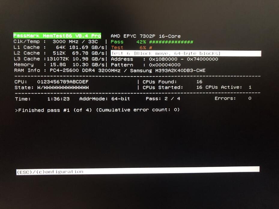

    I reran the MemTest86 v8.4 Pro build version 1001 in Single CPU mode with the suggested CPU #1 (rather than CPU #0).
    In this attempt, I tried limiting the DIMM count to 1 and I still encountered the hang.
    The Supermicro BIOS version 2.1 was released 5 months ago (in February 2020).
    I’ve attached the new log files with the corresponding screenshot of the last time updated. I am unable to post the other screenshot unless I create a double forum post.
