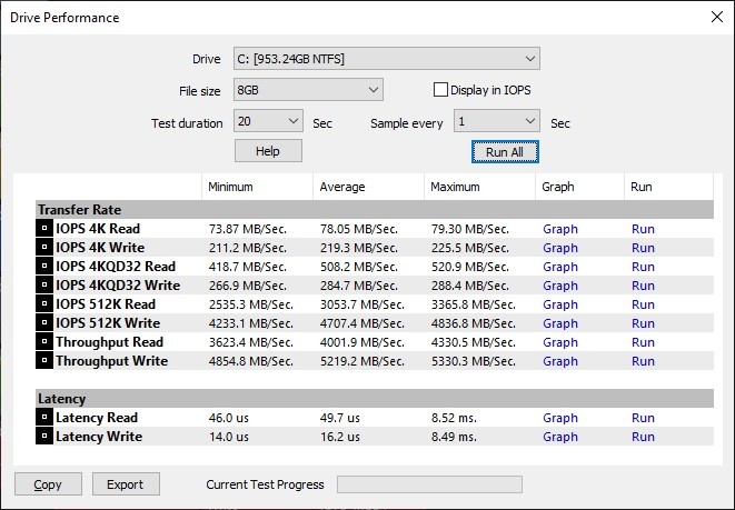

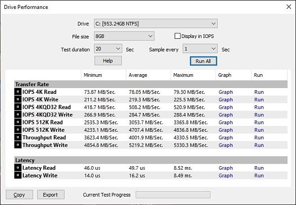

    1s sampling:
Name:	Drive Performance 1s.png
    Interesting. I did only change the sampling time and the Throughput Read/Write did increase considerably. Artefact?

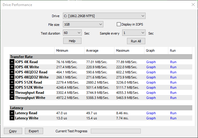

        Throughput Write of 5463MB/sec
        This is an excellent result for this test scenario. Unheard of just a couple of years ago.

          This is in the Help file, but I will post it here as well.
          These are the details for each test scenario from the Drive Performance advanced test window (screen shots above)
          Throughput write only has a queue length of 1 (just like 99% of software applications). So it won't get the same performance as a deep queue with multiple threads.
          All test in this group are also single threaded.

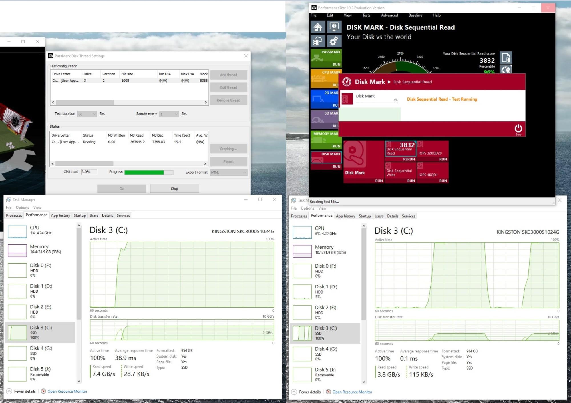

                  This shows the drive is under load and not getting its score from ram, if we are to go by the images you posted. Why can't the regular sequential test just do the same test?
