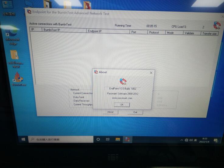

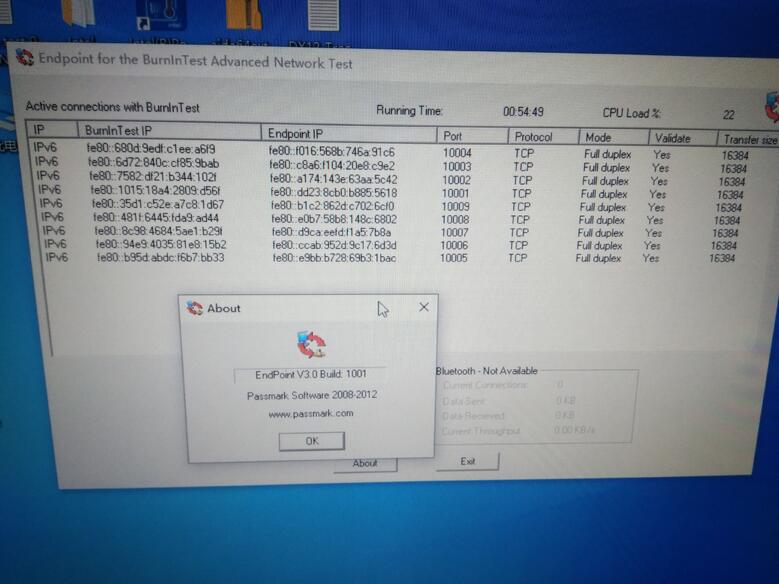

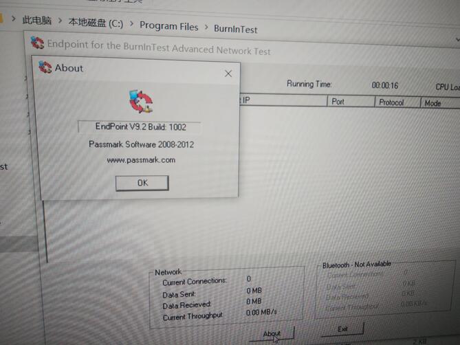

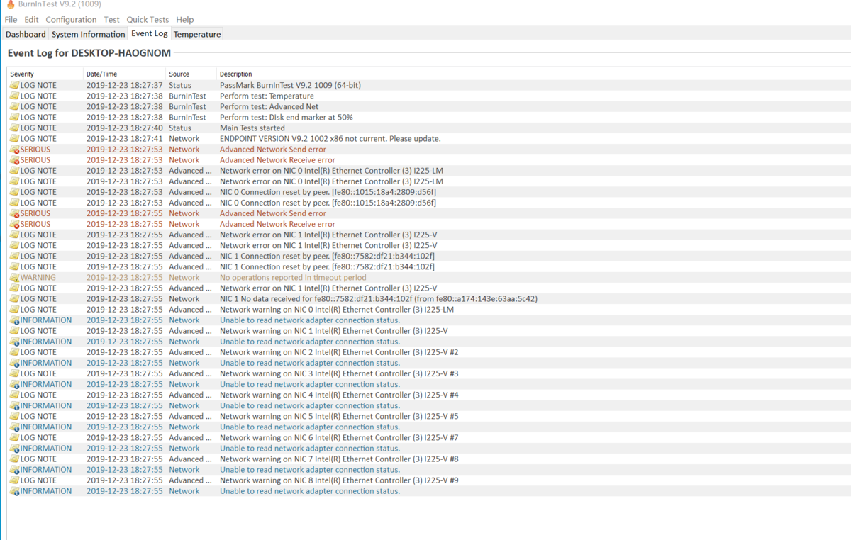

It looks like you might be using an older version of the endpoint than expected, could you please try updating the endpoint version to the one that is in the installer of the version you are using.Network, ENDPOINT VERSION V9.2 1002 x86 not current. Please update.
*edit* Or potentially a newer version, internally the endpoint version has changed but the endpoint packaged with V10 could still have the same external version identifier.Last edited by Tim (PassMark); Dec-31-2021, 01:37 AM. -
There is a log message saying the End Point software isn't up to date.
Can you provide more details of the setup. What PC hardware, what networking environment, how many End Points do you have running?
Download V9 officially. The packaged version is V9 1002,Do you have V9 1009Comment
I tried V9.2 1001,End The version is the same, or error,Help see ThankComment
We don't support V9 of the software anymore. Can you try V10 for both the main software and the end point. Also don't be tempted to mix versions as we have never testing a V9 end point with V10 of the software.Comment

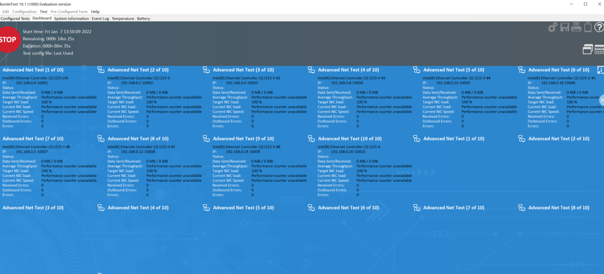

There is no response after using V10 programComment
There doesn't seem to be anything in the log you attached, perhaps there was another log created with a different name?

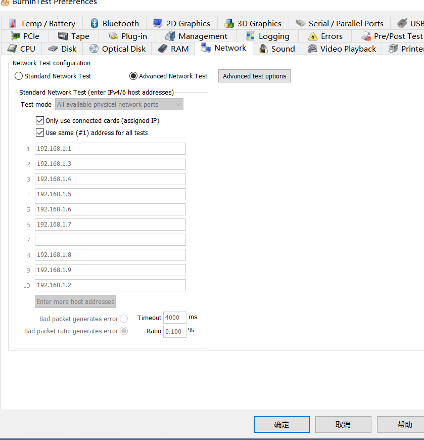

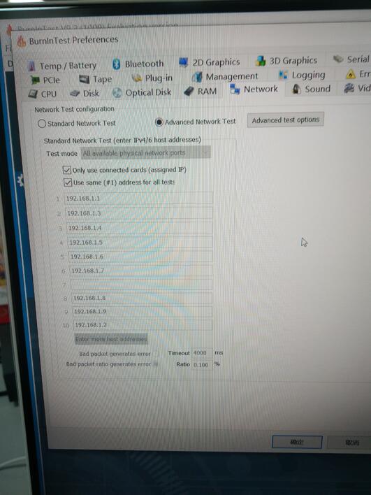

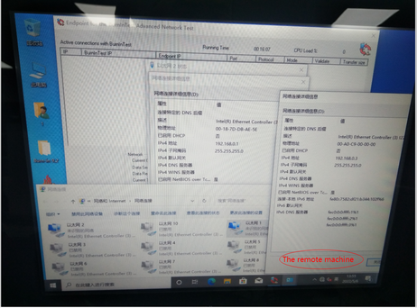

Is the system that is running the endpoint on the same subnet (192.168.1)?Comment
The remote machine needs to be reachable on the network for the network test to work, if it doesn't have a valid IP BurnInTest (or anything else) isn't going to be able to see it.Comment
Yes, the simplest setup is to have the End Point machine and machine under test on the same sub-net.Comment

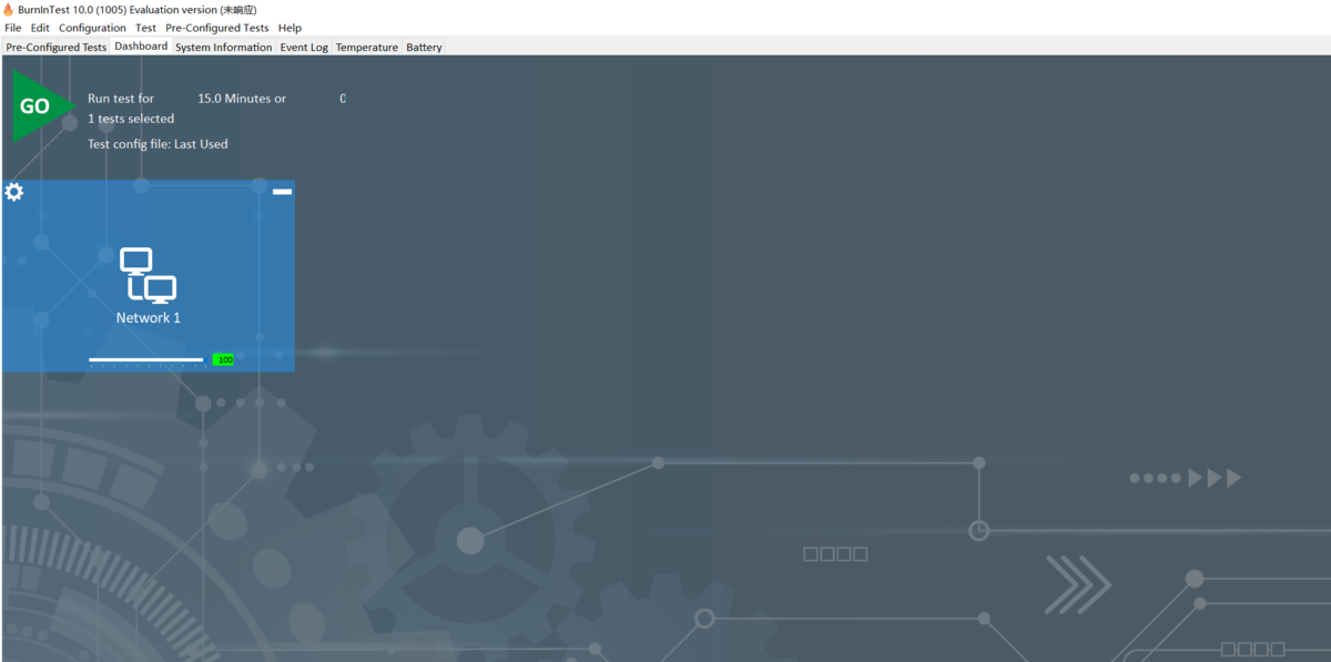

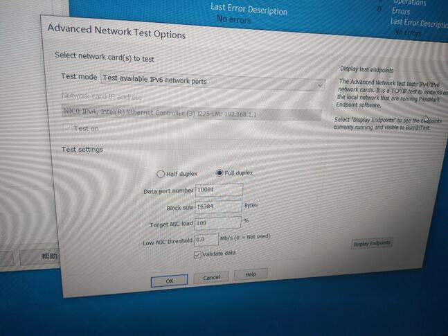

Hi Select an advanced network using V10,start Bunrn No responseComment
What do you mean when you say that there is no response? The images do not really help.
Can you enable trace level 2, run the advanced network test, and send us the logs for us to have a look?Comment

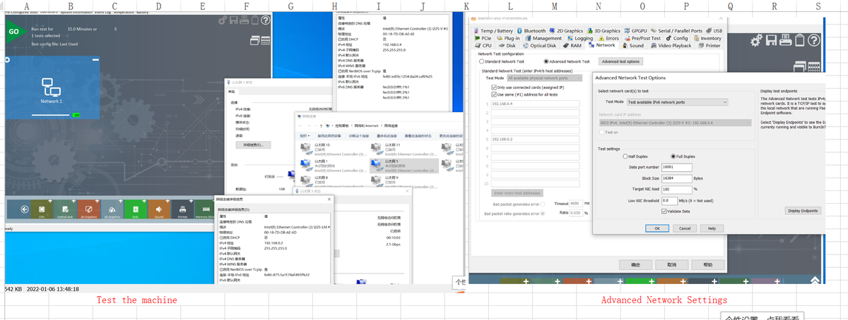

Test machine and remote machine are in a subnet, or error, The remote machine is started ,End PointComment
