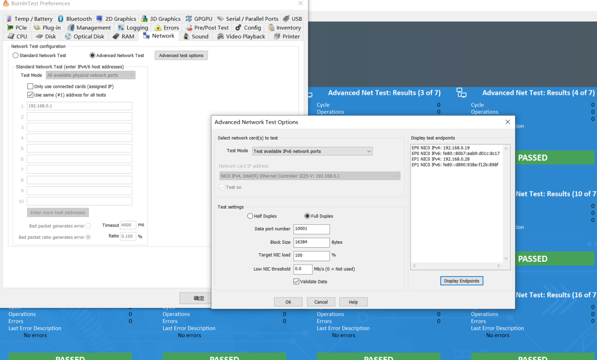

        #33
        You can run the endpoint.exe on another system connected to the same network, the broadcast message from BurnInTest should then find it.
        You can see the active endpoints in the advanced network test options by clicking the "Display endpoints" button.

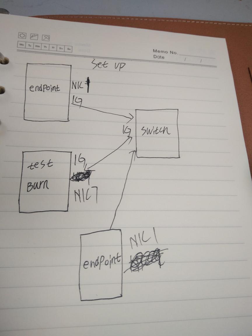

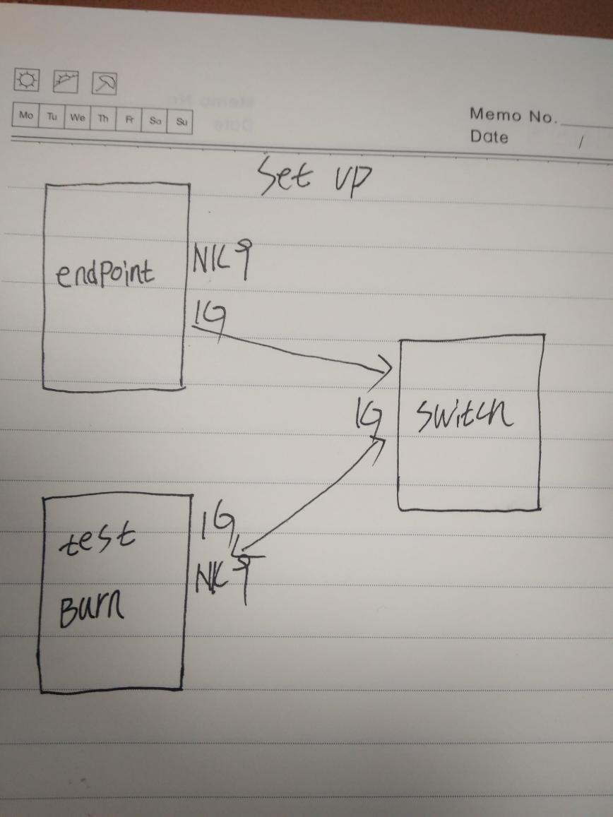

          #34
          Test machine ,7 network cards,Still appear error, I want to ask ,Test machine ,7 network cards , endpoint ,How much do I need to insert ,log .zip

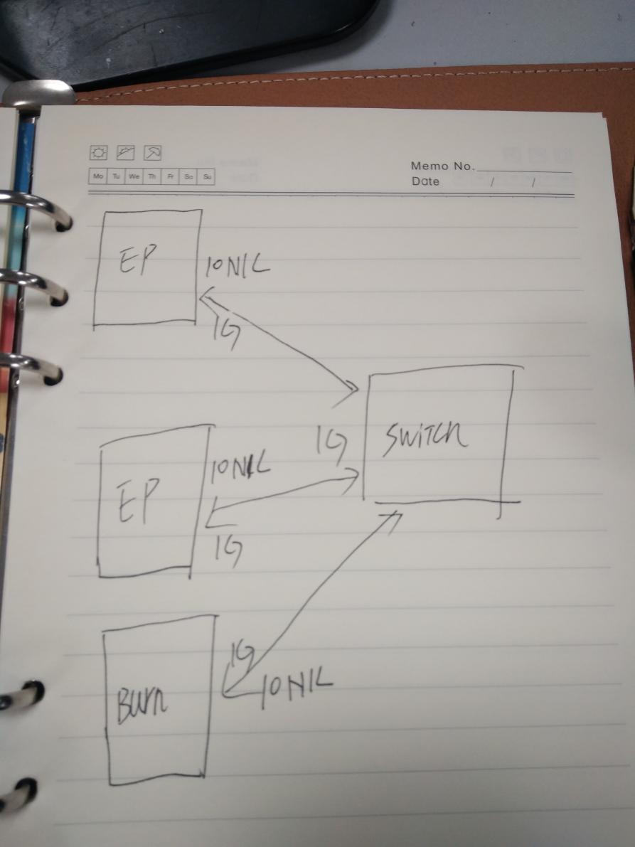

            #35
            burn 10-NIC 1. endpoint 10-NIC 2.endpoint 10-NIC error

              #36
              Add network with two settings,endpoint EP0 EP1 ,Only one endpoint is displayed,Another blank
                #37
                I think there are some balancing issues when so many cards are attempting to start the advanced test which is causing the network card to close the already open connections.
                We'll look into what changes could be made but in the meantime you will need to reduce your amount of cards being tested at any one time (or ignore the initial errors in the first few minutes of the test).

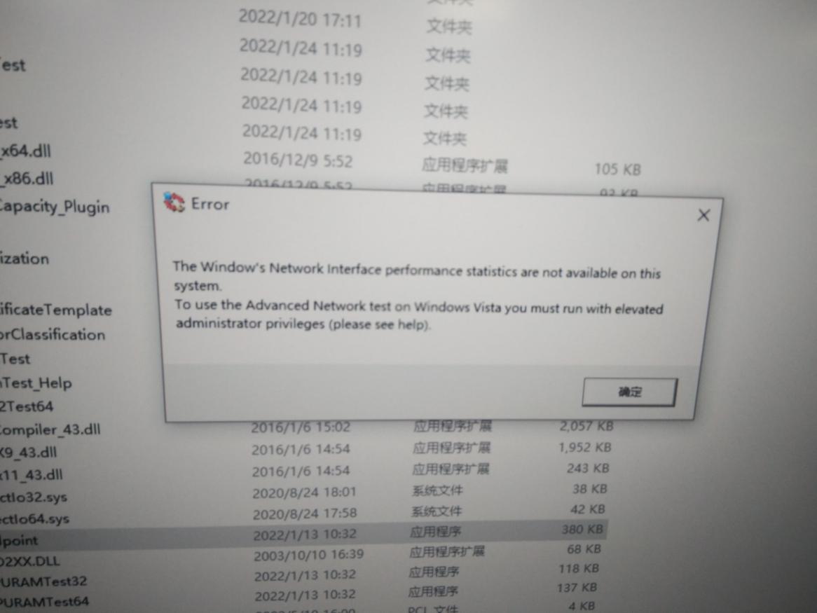

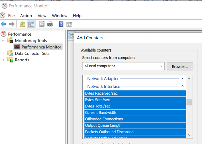

                        #41
                        What does this hint mean!
                          #42
                          The endpoint couldn't load the "Network Interface" performance counters, possibly as it didn't have permission (ie not running as administrator) or they might not be available on the system.

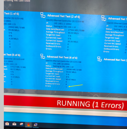

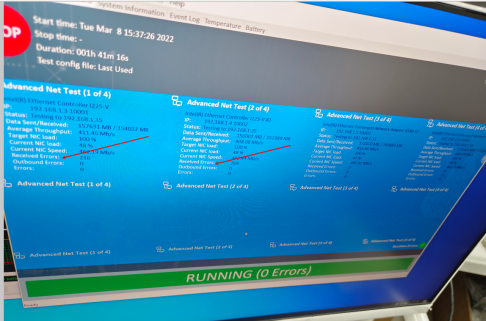

                            #43
                            What is this error,
                              #44
                              The received/outbound error counts are from the network performance counters and are low level errors counts, they aren't included in the BurnInTest error count as they aren't visible from the application level and it hasn't interrupted the data transfer by that point (things like a TCP packet retransmission due to a timeout or loss).

                                #45
                                Hi
                                hello
                                Errors occurred 1 ,烧录会出现错误红色
