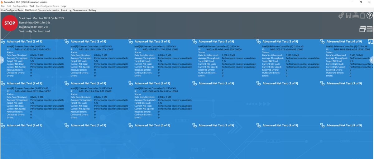

    HI Tim David Simon
    Official download V10.1 1001,Advanced network can not run, help to see, after the trial version of normal to buy the official version

      The error 'Unable to load performance counters' indicate that BurnInTest cannot retrieve information from the network adaptors/ Windows Performance Monitoring. Try updating the drivers for the network cards. Also check in Performance Monitor that you can add network adaptor there for monitoring:
      https://forums.passmark.com/burninte...mance-counters
      It also looks like between using v9 initially and v10 in this forum thread, slightly different systems were used for the test machine?
      How are the test and remote machines connected?

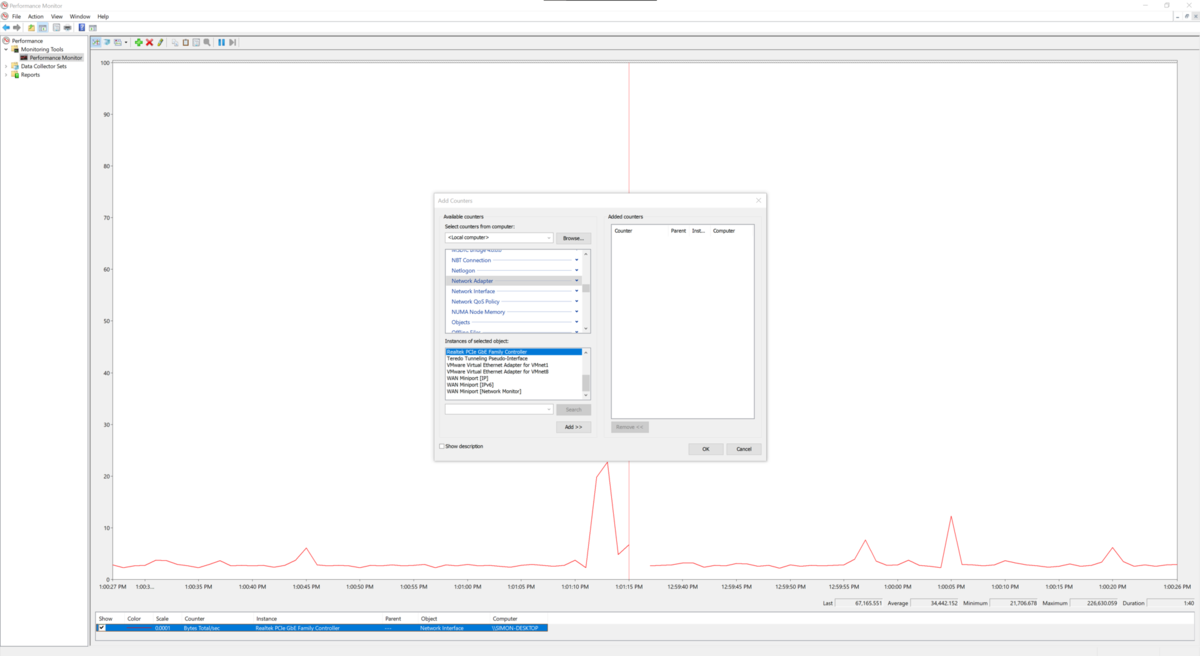

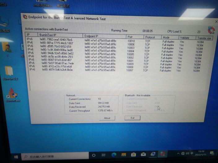

        In the picture,How to solve

          Counter open normally, Burn V10 but it seems to appear as soon as you turn it on error,Help to look at

            HI Tim David Simon
            Permon Already open Burn appear error

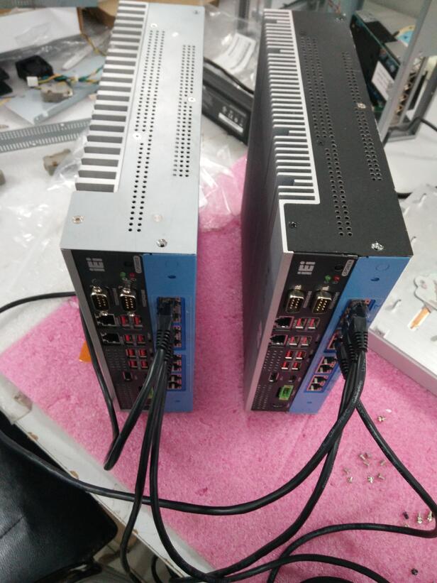

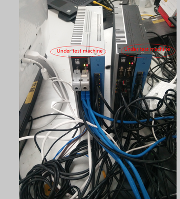

                I think there may be an issue with a single endpoint trying to handle all the connection requests at the start of the test when you are trying to test so many cards, the errors are only occurring at the very start and once started it seems that you aren't seeing any more errors.
                Can you please try reducing the amount of cards you are testing to see if the test will start without error, or you can try adding more endpoint systems to the network.
                Also you are trying to set a target network load of 100% for the cards while the endpoint system only has a single card, this isn't going to be achievable.
                Another point referring to this picture, it's not entirely clear but do you have the endpoint system and the test system directly connected to each other and not via a switch? If so this is not how it should be setup, the system under test should be connected to a switch and one or more endpoint systems available on the same network.

                    #24
                    For your two systems "under test", is one of these the endpoint? If not and you are trying to run the advanced network test on two different systems at once this isn't supported (the test is designed so there is one system running BurnInTest which will connect to one or more systems running the endpoint). Running more than instance of BurnInTest running the advanced network test on the network will cause disconnections and errors.

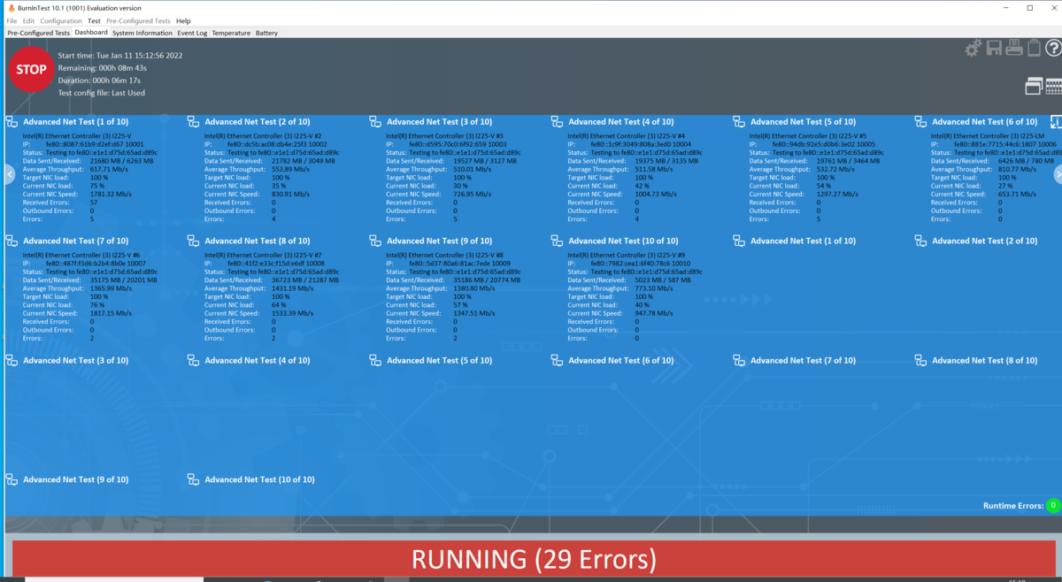

                            #28
                            EndPoint NIC 1,Intermediate switch ,Testing machine ,8-NIC fail,Advanced network seem unable to run 10 !

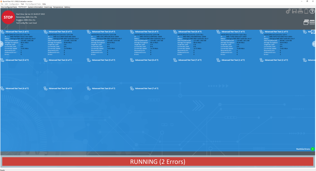

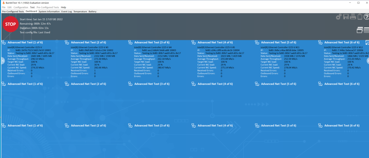

                              #29
                              NIC More than 7 There will be failures,The middle is through the switch,6-NIC PASS

                                #30
                                6-NIC PASS,7-NIC Errors
